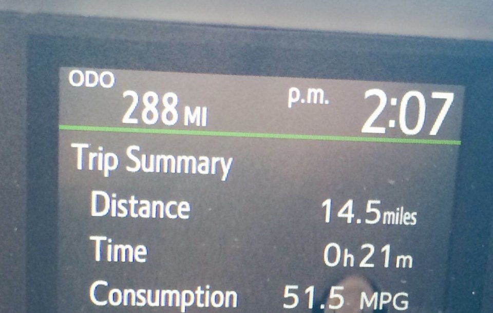

    Is this an average of the whole trip? It seems to put the mpg I had on there right before I turn off the car. Is there a way the car can show a lifetime mpg?

    yes, every time you power down, you get the average for that trip. unless the c is different, the only way to get lifetime is to keep fill up records, or dedicate trip a or b.
