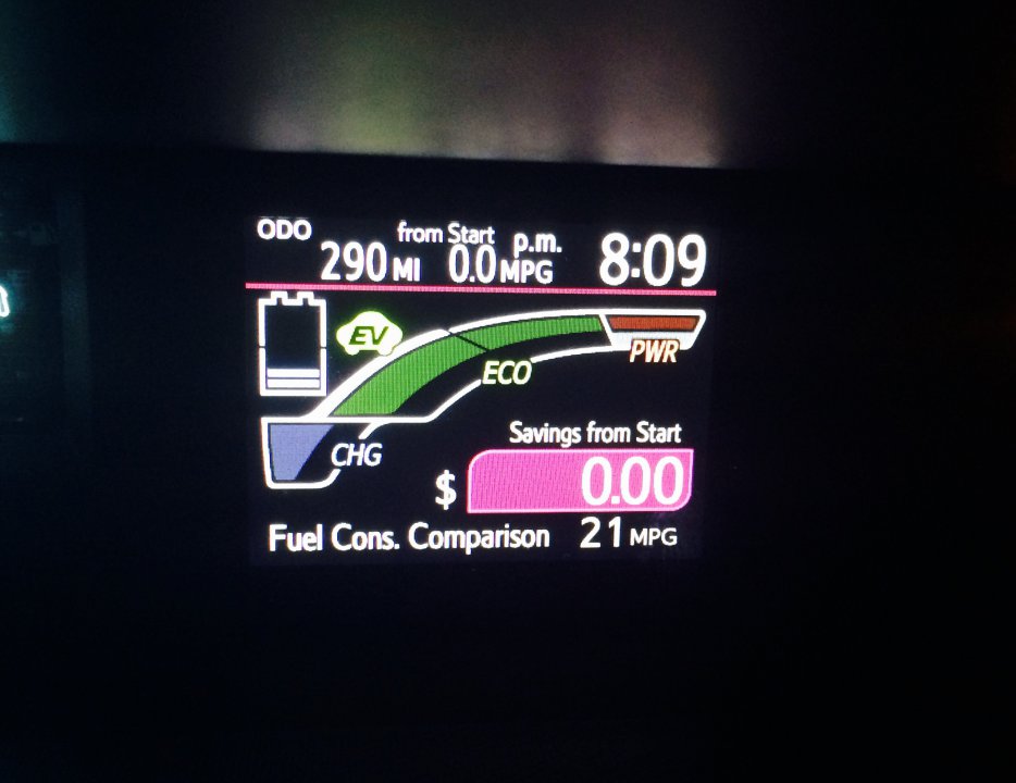

  15. Britt Jacobsen
    Britt Jacobsen Junior Member
    Oct 26, 2014
    48
    Deming NM
    2014 Prius c
    Today I went up to 44 mpg because I was trying the pulse and glide technique. I don't have it down completly but working on it.
    minkus, robertmaria and JimboPalmer like this.
  16. Britt Jacobsen
    Oct 26, 2014
    48
    Deming NM
    2014 Prius c
    Ok so with the 2014 prius c display it shows 'charge', 'Eco' and 'power'. I assume the best fuel economy would be to stay in the Eco and not the power and the even better fuel economy would be the low part of 'Eco' which is when the 'ev' light comes on. Is this correct? Is the 'power' mode all gas and no electric? That's what I hit when my rpm's are high.
  17. JimboPalmer
    Apr 14, 2009
    12,470
    6,878
    Greenwood MS USA
    I am going to answer as if it is the same as my v, then the actual c owners will point and laugh.
    If you hit the brakes lightly, you start to fill the CHG. Once you are pressing hard enough to completely fill CHG, any more braking will be the disc brakes, rather than the regeneration. (because the Prius emulates engine braking, CHG may show tiny amounts of charging when 'coasting'. This is why 'glide' is not just coasting) When slowing, I try to just stay above the CHG area, as converting electricity to battery chemistry is not very efficient.
    Let the computers choose when to EV, do not try to fool them.
    In the v, above the line in the middle of the green ECO is where it never will EV. Below that line the computers may choose to EV.
    In PWR, fuel economy is not the prime concern of the computers. I tend to stay in PWR for very brief moments, then cruise.
  18. rjdriver
    rjdriver Active Member
    Apr 7, 2012
    409
    170
    Rhode Island
    >>>>Is the 'power' mode all gas and no electric?<<<<
    When you are in the the power (red) section of the gauge you are most likely using both gas and electric. Use it when you need it, but try to avoid it if possible. The best fuel economy is in the lower portion, and as you noticed, that's when the EV symbol will pop up which means you are running on electric only. I believe the maximum speed you can go and stay in EV mode is about 43 mph. It requires a light touch and usually a pretty flat road to stay in that mode. When you start going up hills the gas engine will probably kick in to maintain speed.
    Change the dashboard gauge to the Energy Monitor and watch that for a while. It's the best way to see how the car works. The car controls everything based on what you do with your right foot. It's fascinating to watch. It's like driving a computer
    Congrats on getting up to 44 mpg. Sounds like you are getting the hang of it.
