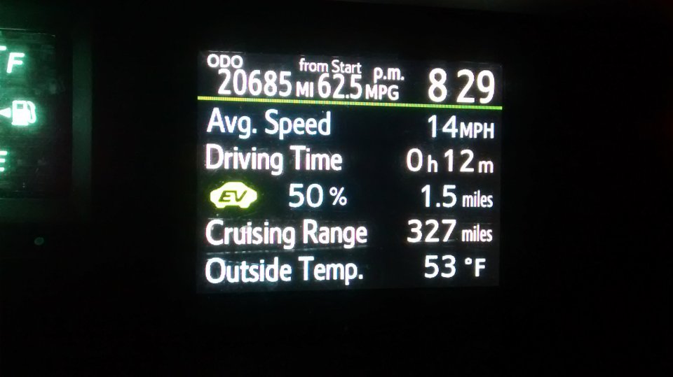

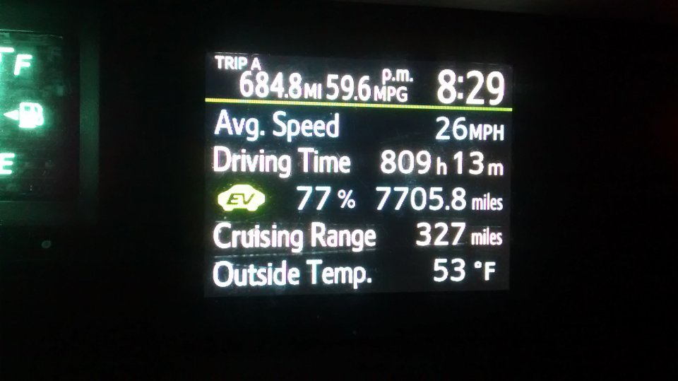

    Here's an example (pictures included at bottom):
    • I have 20,685 miles on the odometer. I use trip A to keep track of lifetime mpg and such.
    • The trip A screen (which has never been reset, so it technically has the same number of miles on it as the odometer) says 684.8 miles, because it's rolled over from 9999 to 0 twice.
    • It says EV 77% 7705.8 miles. 7705.8 EV miles/20,685 total miles = 37% EV, not 77%.
    • So for the EV % calculation, if the trip odometer has rolled over past 9999, it does the EV % calculation as if the trip odometer has 10,000 (edit: or maybe 9999?) miles on it (7705.8/10000 = 77%), regardless of the number of times it's "rolled" past 9999.
    • So basically, everything is correct except the EV % and the number of miles on trip A.
    • Eventually, once I reach 10,000 EV miles (sometime around next June, maybe), it'll say 100% EV. And then I'm curious to see if it will go over 100% or just stay at 100% forever.

    gotcha.;) that's a heckuva ev % for a non plug in, is that typical for c owners?

    I knew the numbers were still the same, I didn't realize that the percentages were off. I reset mine once I saw it didn't go past 9999. Thanks for the info and pictures. That helps explain it much better.
