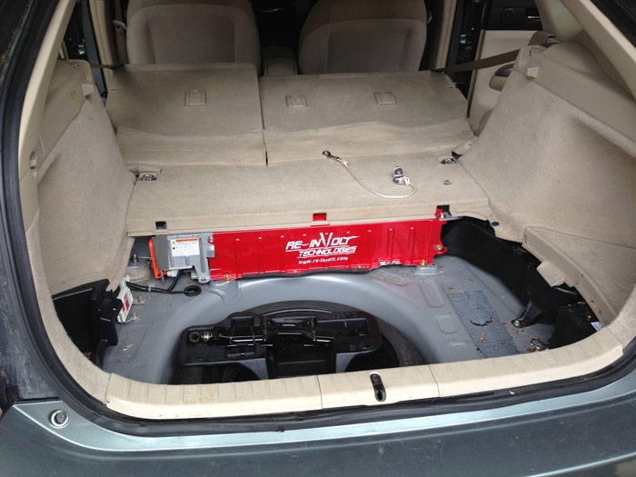

  13. jefe
    jefe Member
    Sep 10, 2010
    169
    Cary, NC
    Out with the old:
    In with the "new":
    JMD likes this.

    Did it get u home?
  15. jefe
    jefe Member
    Sep 10, 2010
    169
    Cary, NC
    It did. Triangle of death no more.

  18. jefe
    jefe Member
    Sep 10, 2010
    169
    Cary, NC
    I've been driving for a few days now, and I have an update. First, Re-Involt paints their batteries red. It's cute, but it smells. I'm sure the smell will fade, but it's kind of annoying right now. especially considering that no one will ever really see it.
    For the first couple of days, I never saw the battery indicator show a green SOC. I called Re-Involt and asked about that, and he told me basically that the "idiot lights" don't always match the actual performance. :rolleyes:
    I did finally see a green SOC after a couple of days, so it may have just been coincidence and I was scrutinizing it more than usual.
    Finally, I expected my mpg's to bounce back quickly, and that just hasn't been the case. Ordinarily I get 43-45 mpg. Toward the end, my mpg's were dropping to around 40. then, when my battery died, I drove it for a bit, and it was getting around 32-35. Now, with the "new" battery and a full tank of gas, I'm seeing 38mpg so far. On trips that used to soar above 50mpg, I barely touched 50 on one 5 min. interval.
    Again, this may be over-scrutinizing, and coincidental. I'll just have to keep watching it. But I'm starting to kind of worry that I made the wrong call. Maybe Luscious is right and the gen2 cells are not worth rebuilding from anymore.
    Paresh Trivedi and JMD like this.
