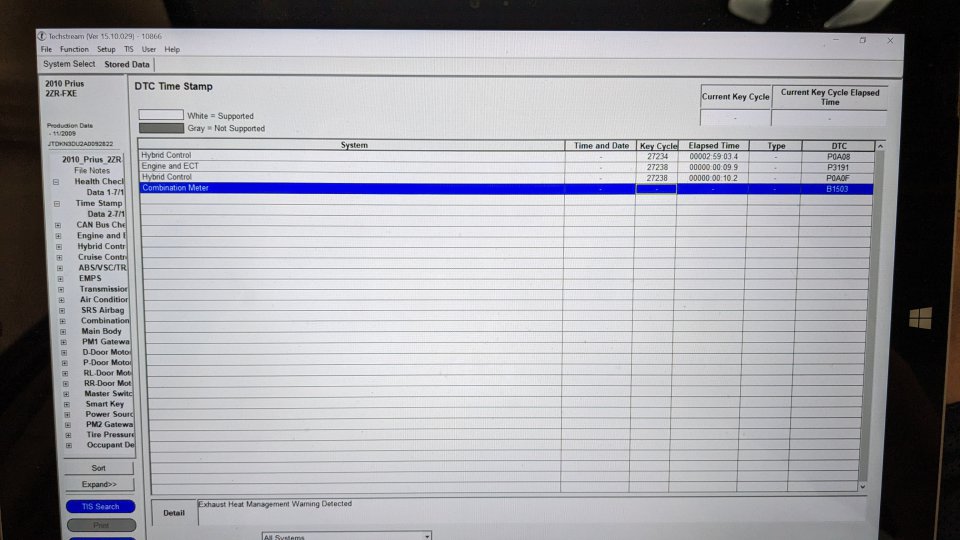

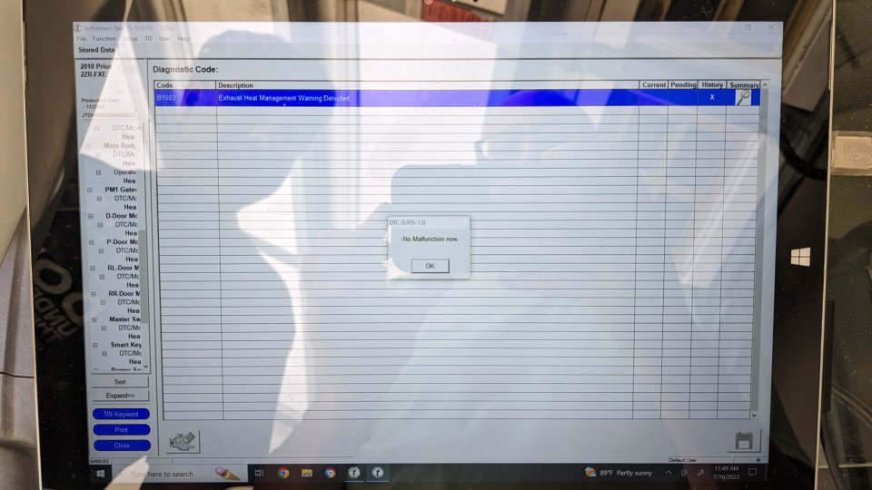

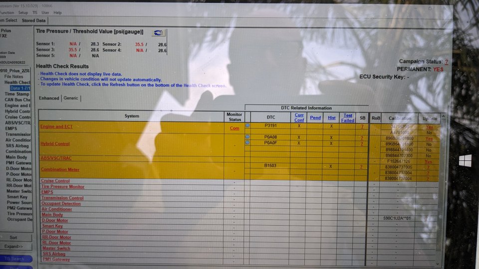

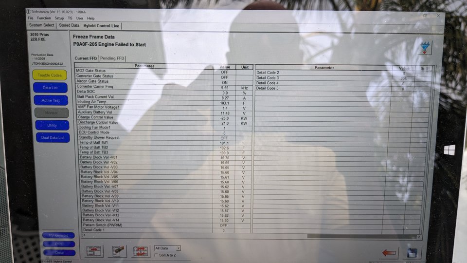

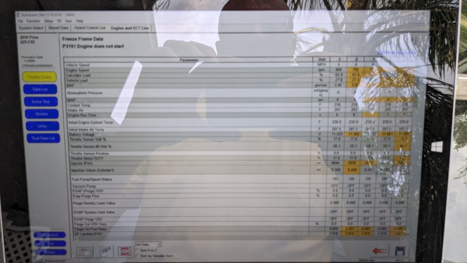

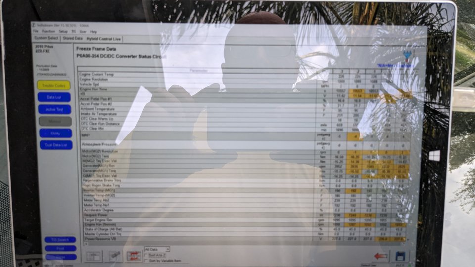

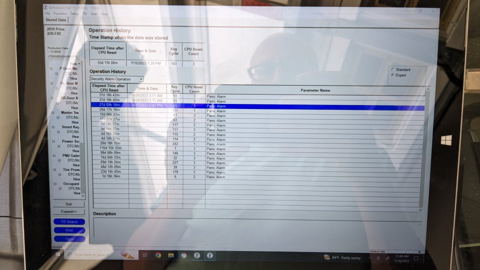

    Car was sitting in park with the AC on lowest temp highest fan speed recirculate 95° f Day full tank of gas didn't have any codes was running just fine. I noticed the car was off engine off warning lights on dash as shown in these codes came out. Car wouldn't move. I had to power it done cycle power back on and it would move slowly and then it would safety itself off again. Had to do that a few times to get it to move into a parking spot. After I got flatbed home I was able to drive it up to hell into the driveway. I have cleared the codes I have checked the thermostat and the water pump using techstream. The cooling fan works using text stream the water pump works using text stream The thermostat works correctly in a pot of boiling water. Antifreeze was full. No recurrence of the problem since checking everything. I even pulled the water pump off and checked that the fan spins the impeller which it does. Any ideas why? Seems like p0a08 popped up 3 hours prior to pulling codes which would make it the primary code. Or would the overheat code be the primary code and it's historic but not current making it the primary problem or contributory problem? If you look at the hysteresis you'll notice that that circuit was 230 Fahrenheit. Seems like there were two problems at the same time which doesn't really make sense. Integers the car 100 miles since clearing codes and it's running fine. Yes it has the original inverter. But when inverters pop they don't suddenly work again so I'm a little dumbfounded on this one

    Are you planning to try to reproduce the issue?
    Sounds to me like you just over stressed the cars capabilities to cool it's self off and a chain reaction resulted in one system borking the next until the ECU just gave up and locked out hard.
    Idling for however long it took with A/C on full at 95 F - the fans must have been screaming by the time the car shutdown.
