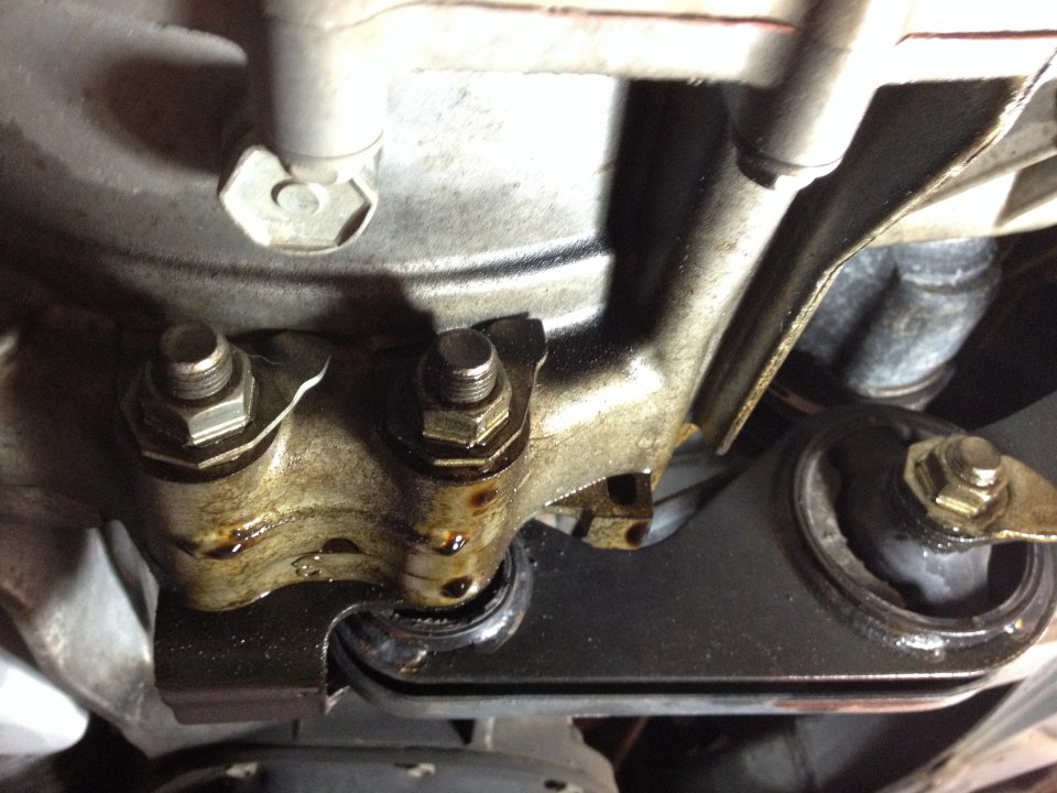

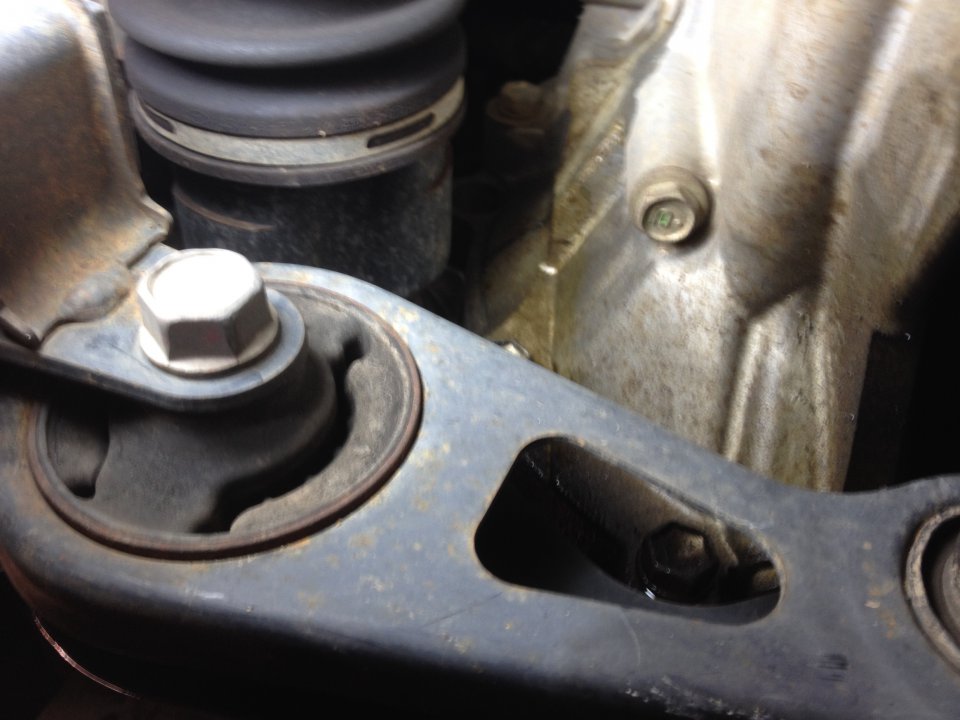

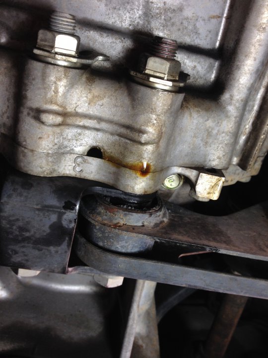

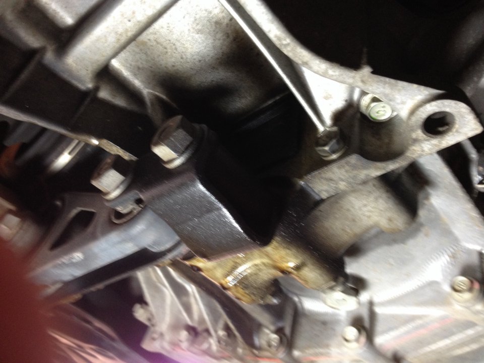

    I have noticed oil spots under my 06 lately and finally got under it to see where it's coming from. It's collecting and dripping from the bottom motor mount but it's hard to determine exactly where it's coming from. I can't tell if it's coming from higher up or down low and running back and up from the wind. I just cleaned it with degreaser and have it running to hopefully dry it and be able to see where it's coming from. I will post some pics to see if anyone else has had this problem.
    Let me know if these pics don't show up.
    And another
    More

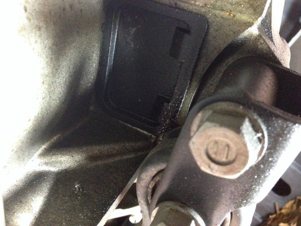

    Well it appears to be coming from this hole but I can't say for sure yet as I washed everything really well. Not sure if water got in there and that's residual water that hasn't came out yet. That being said I don't honk that's the case. Is that hole normal? It doesn't look like it would be but can't say for sure.
    This is just my luck, I am looking at spending 18-20k to get my boat running again and now this
    I just watched a video online and the hole is normal but this may be tranny fluid instead of engine oil. Its hard to tell because both would be dark since I was due for an oil change and the trans fluid is also due.
    Any ideas?

    That looks more like engine oil as the transmission oil is very red in color. As long as you keep an eye on the oil level and top up as required there is no rush to get this fixed. Putting an additive in the oil that softens seals may help the situation, and a drip tray on the floor where the car is normally parked will help stop a large oil stain.
    You do not say how many miles the car has covered? If the millage is high when you decide to tackle the problem a low millage replacement engine might be a good idea since the engine has to be removed to change the seal.

    Clean it good and leave it idling (get it to inspection mode). It should be clear if oil is leaking from that hole (“clutch”housing drain hole). If it’s then it’s either engine oil from engine rear main seal or transaxle oil from transaxle front oil seal. You should be able to tell what it is by collecting oil from cleaned surface and from dipstick to paper and comparing the two. If its engine oil it’s not that critical (if leak is small) since in the “clutch”housing there’s only torque limiter and dampener. You just need to check that oil level doesn’t drop. If its transaxle fluid its bit harder to check transaxle fluid level. Replacing either one of those seals is same job you have to take transaxle or engine out of car. Easiest way is probably just take them out together and then separate them.

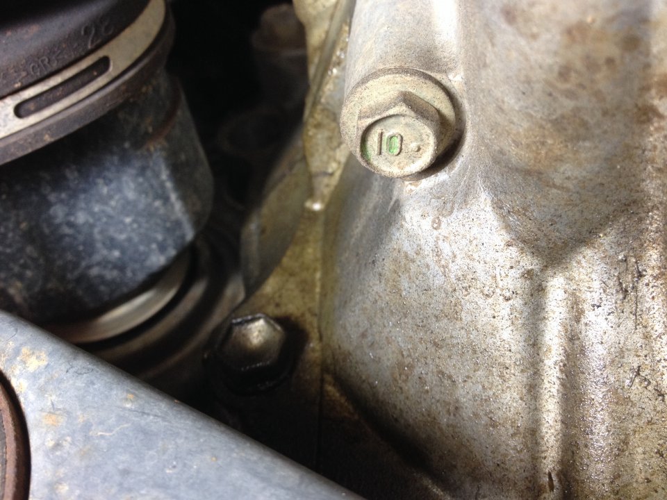

    The third picture shows the oil to be coming from the crankshaft rear oil seal. The oil makes it's way down from there and out of the hole between the two bolts. The oil will also find it's way out through the joint between the engine and transmission if it gets onto the rear of the flywheel and is thrown off as it spins .Although I would not say this is a common fault it is a known fault. The transmission oil is thinner, and even when very dirty is still very red in color. A paper towel will show up the color.

    It is indeed engine oil so it has to be coming from the rear main seal. I'm going to keep an eye on to make sure it doesn't get worse.
