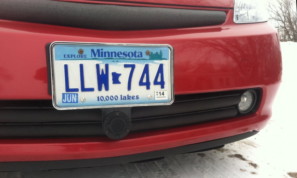

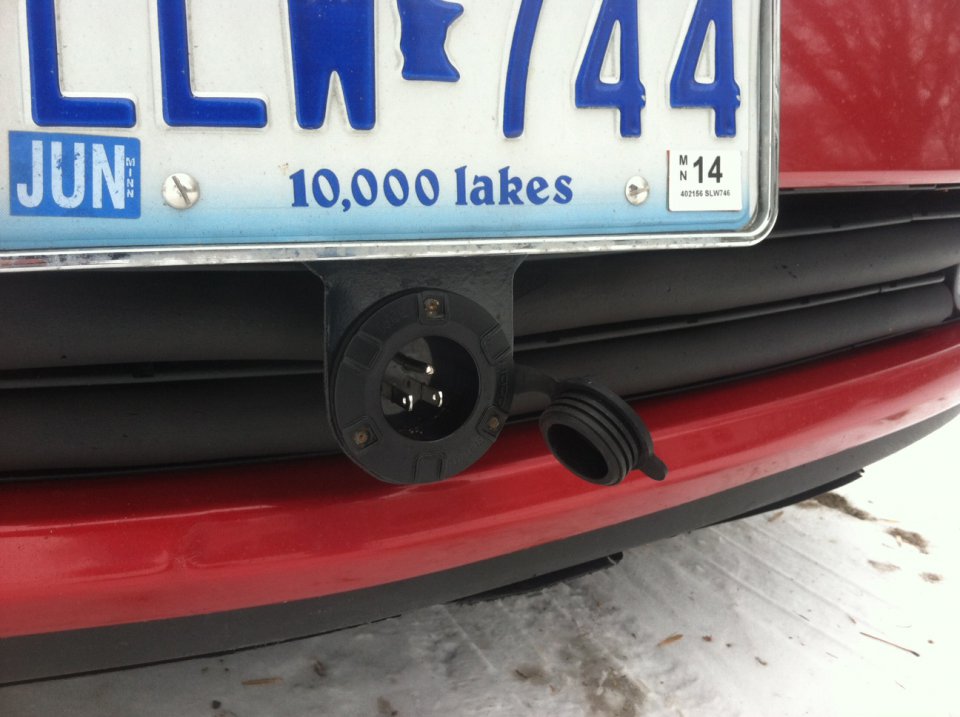

    The EBH Plug may look a little obvious but if I forget to unplug my cord it pulls right out of the socket.

    Thanks. A buddy of mine made it out of aluminum and then bolted it in with the license plate. Like I said, I can forget about it and back up and it'll just pull out. I used a product from Amazon called NOCO Genius GCP1 Black 13 Amp 125V AC Port Plug.
