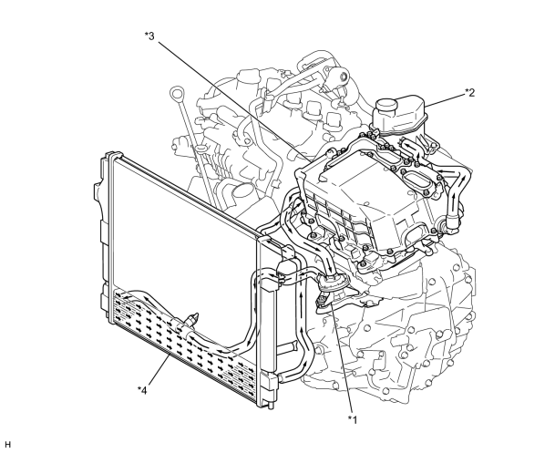

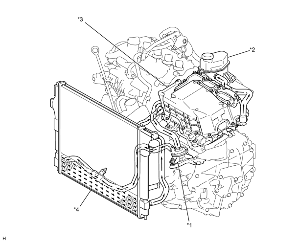

    It would be a bad idea to block 100% of any radiator any time. But in very cold weather, it's necessary to restrict the airflow through the engine radiator, otherwise there's too much heat loss, and the engine never gets up to the operating temperature range.
    The inverter cooling system never needs to be blocked; it works fine at cooler temperatures, and blocking it could result in overheating. In the Prius, it's the lower portion of the radiator.
    When the radiator is cooled by a thermostatically-controlled electric fan, there's a bit more flexibility. When temperatures rise, the fan can accommodate the need for more cooling. That's why I haven't needed to block the grill with my last few cars. I still have to do it with my Dodge Ram occasionally.
