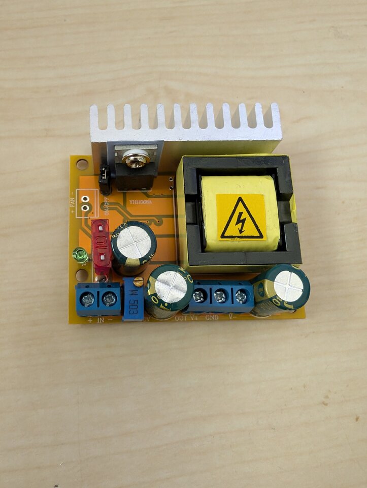

    Tomorrow I will be receiving a high voltage boost converter... My installation to charge the 12v battery has been working really well... now I am exploring to use 15mA charge with this converter to mantain the hybrid battery. I am planning to add a relay NC with ignition, so that it only charges it when the car is not turned on.
    booster

    China?
    I am wary of these fakes.
    There is no galvanic isolation.
    Connecting to a high-voltage battery can lead to a powerful bang.

    Now, I need to test it to ensure negative output is isolated.. I don't want to mix low and high voltage negatives..
