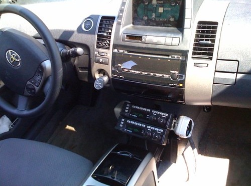

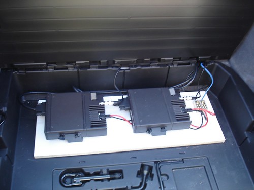

    I have no issues with my setup.. 2 Astro Spectra's, one in VHF and one in UHF.
  10. KK6PD
    KK6PD _ . _ . / _ _ . _
    Mar 24, 2008
    4,003
    946
    118
    Los Angeles Foothills
    Justin, nice clean install, is that a dual band glass mount, or do you have another one on the other side?
    What's the VSWR with those antennas?
  11. grinthock
    grinthock New Member
    86
    VSWR is about 1.3 across the ham band... I have 2 - one on each side -- they are dual band so you COULD use a single one with a duplexer. To be honest, for in the city - it works perfectly well. Not the highest gain - but it works quite well.
    It's totally discrete, people hardly even know there's a radio in the car..

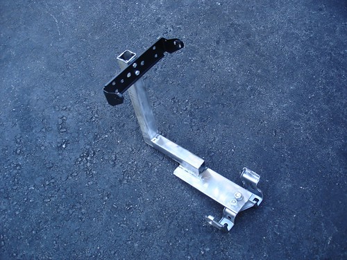

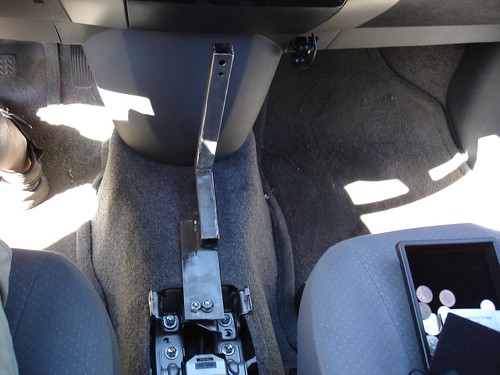

    The bracket was custom fabbed by me to hold the radio heads. This is a NO HOLES install. Not one hole drilled, not one modification. The car is leased so I wanted to make sure I could easily reverse what I did.
    Bracket fab...

    Hey justin great looking setup. I'm thinking about trying to setup a mobile rig in my prius. Could you describe how you've mounted the actual xcvr bodies and how/where you ran the wires up to the face plates?
    Thanks in advance
