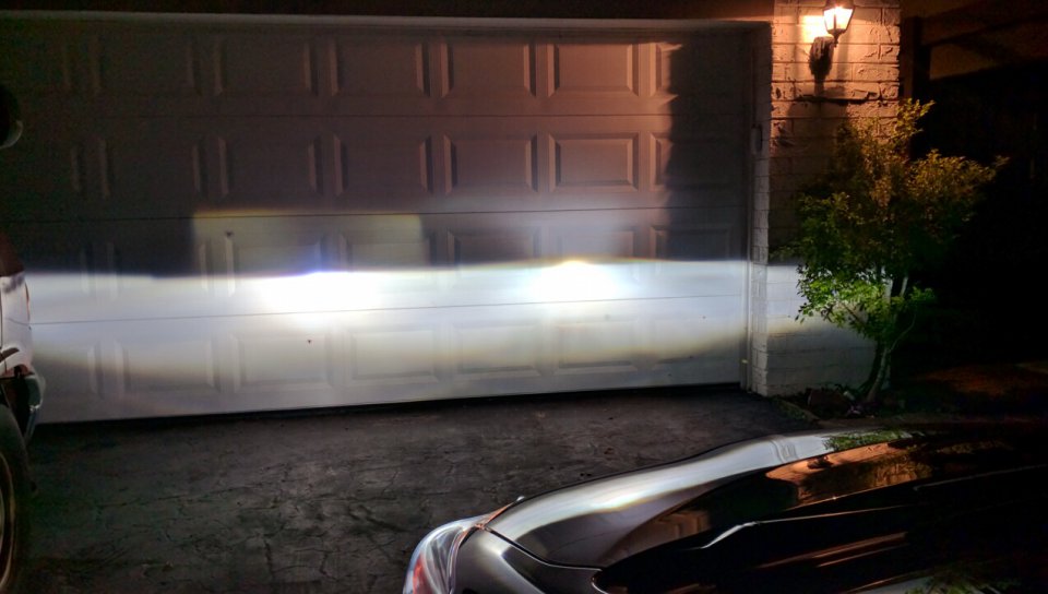

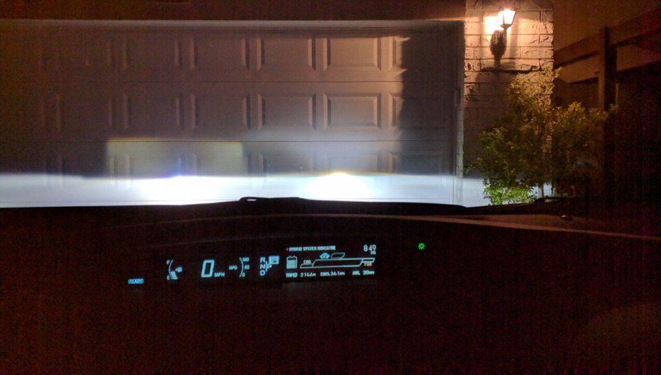

    Anyways here's some pictures wondering why I'm getting this strange rectangular light projection on my left side really looks weird
    Any ideas what could be causing that ?

    Google squirrel finders... they are cutouts in the cutoff shields that allow light to shine above the cutoffs. Intended to illuminate overhead signs and upcoming road signs as you drive.
    Here's a pic of what they look like close up against a garage door (with H9 halogen bulbs):
    You can do a mod to block the squirrel finder cutouts. Then you won't have the extra glare emitted above the cutoffs. On coming traffic and people driving in front of you will appreciate it. (with 4300K HID):

    Interesting when i called The Retrofit Source about it the guy I spoke with said never seen anything like this before said must be a bad bulb
    Real knowledge support :)
    Does anyone actually know how to do the mod that fixes this on the Prius or a how to link to it ?
