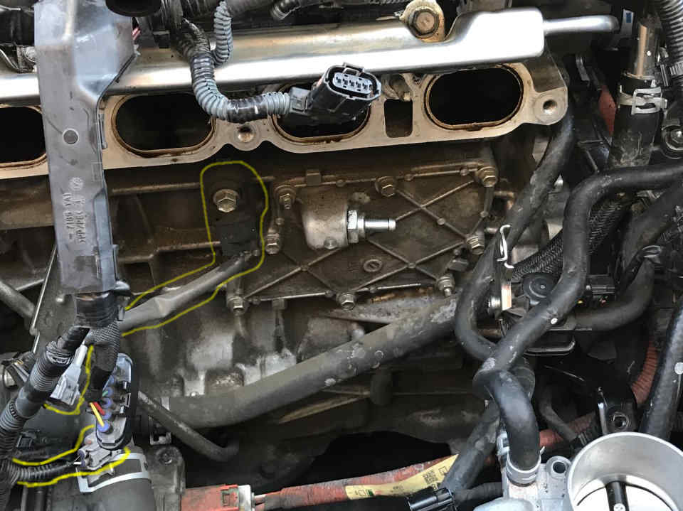

    3) I had to rewire a couple of pigtails. The two in question are directly wired to one another. One sits on a connector bolted to the front of the block (underneath the air intake manifold). This pigtail is wired directly to another pigtail which attaches with a clip to the dipstick bracket. I did not carefully note which wires were connected to which pins. The pigtails are oriented in such a way that I connected the right-hand pin on one to the right-hand pin on the other, and similarly connected the right-side pins. If this is incorrect, what are the consequences?

    The sensor beneath the intake manifold sounds like the knock sensor:
    Looks like the wire colors are white and black, and should connect white to white and black to black at the DG1 pigtail connector, and white to pin 1 and black to pin 2 of the G1 knock sensor connector itself.
    (The connector shell itself is black plastic, there.)
