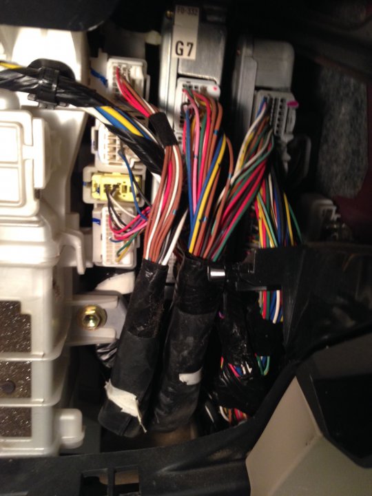

    Has anyone done the potentiometer installation in the instrument panel? I thought I could get this fix done on my daughter's 2005 Prius (sensor is toast...arms were broken off). I got that connector off and sealed up, and built up a small project box with the 5K pot and the 20K resistor (very close to 0-3.9K pot now), wires ready. Planned to just use the crimp-style splices on the wires near the headlamp leveling ECU connector H12.
    But, I have not been able to locate that connector. The diagram on page 46 in the wiring manual shows it behind the glove box area, but it looks different than that diagram, so I cannot be sure which is H12.
    Has anyone done this and taken pictures they could share?
    Thanks in advance!

    I found the wiring diagrams with these connectors, plus the line drawing showing where H12 "should" be, but was not certain if I was looking at the correct connector... I would have guessed the lower left connector in this shot, but yellow wire is on the end of a 22-pin connector, but diagram says yellow wire goes to pin 20. I had limited time to dig into this, and did not want to take any chances.

    As in picture posted by 500VDC you need to go to the plug on far right. Harness connected on a small black box above ground plug.
    Yellow is
    Pink is 5V reference
    Blue is signal for module
    You will need to connect yellow and pink on extremities an blue in middle
    You will also notice there are 2 blue wires on plug, we are using the 1 on same side as pink wire
    This site has helped alot for this issue, if someone needs help please send message

    Thanks for the explanation! Did you try putting a resistor in parallel across the pot? I don't see why this would change the way the circuit works. I googled up page 05-1738 of the manual and it seems to be saying that when you put 4.5v between pin 2 and pin 20, the voltage from pin 5 to pin 20 should vary between 4.5v and 0.5v. This makes me think that if you have a 5k pot, the thing to do would be to put a 620 ohm resistor between the pot and pin 20, so that the voltage at the center lead of the pot never gets too low.
    I would like to try this --- if I can figure out how to get to the wires behind the glove box (or wherever they are) in the picture posted by 500VDC. I've googled around but haven't been able to find this information. I'd love it if someone could tell me how to find out this kind of thing. This is my first Prius repair attempt. This thread has been incredibly useful, but I'm stuck on the most basic things!

    You are exactly right. Remove the lower glove box for access.
    Oh - you don't know how to remove the glove box? Open the glove box and empty its contents.
    Find the damper on the far right of the glove box. Note how it is attached, take a photo if necessary for reference.
    Then use your right hand to pull the lower end of the damper off its mounting pin. Use your two hands to squeeze the glove box sides inwards, so that you can lower it. Pull the glove box out and away from the pivot.
    Now you have access to the cabin air filter (the right edge of which is visible in the photo) and also will see the ECU wiring as in the photo.
    Consult techinfo.toyota.com for an electrical wiring diagram and for factory repair manual info.
