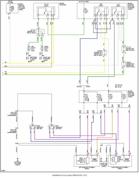

    I think in the US if you have fog lights you have HID lamps. There have been many reports of bulb failure with HID's with similar symptoms as yours, but it is usually just one that goes out, and then relights after being turned off. I do not know what the details are but I believe Toyota in the US will replace the bulbs.
    The left and right headlamp circuits are separate as far as fuses are concerned, but they do share a common relay shown as DM or might be DIM relay in the fuse box. Swapping this for a similar relay in the box would rule it out. Circuit diagram below if it helps. I am sorry from this distance I cannot be of more help. Headlamps & Fog Lamps wo_DRL 2of2.jpg

    I should have welcomed you to PC forgetting my manners.
    There is another page to the circuit diagram, but I think the information or likely area of problem is on the page posted. If you need the other page let me know.

    Swapping the DM/DIM relay with the FOG relay should transfer the problem to the fog lights if it is the relay that's at fault.
    John (Britprius)
