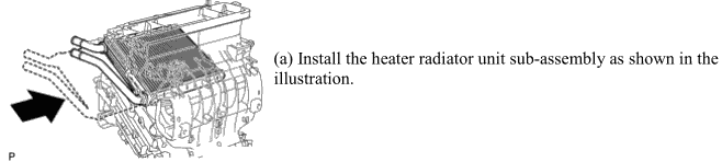

    Does anyone know which connection on heater core is in and which is out .

    Believe upper elbow is gozinta, lower one is gozouta. (Also believe it would probably exchange heat just about as well even if connected the other way....)
