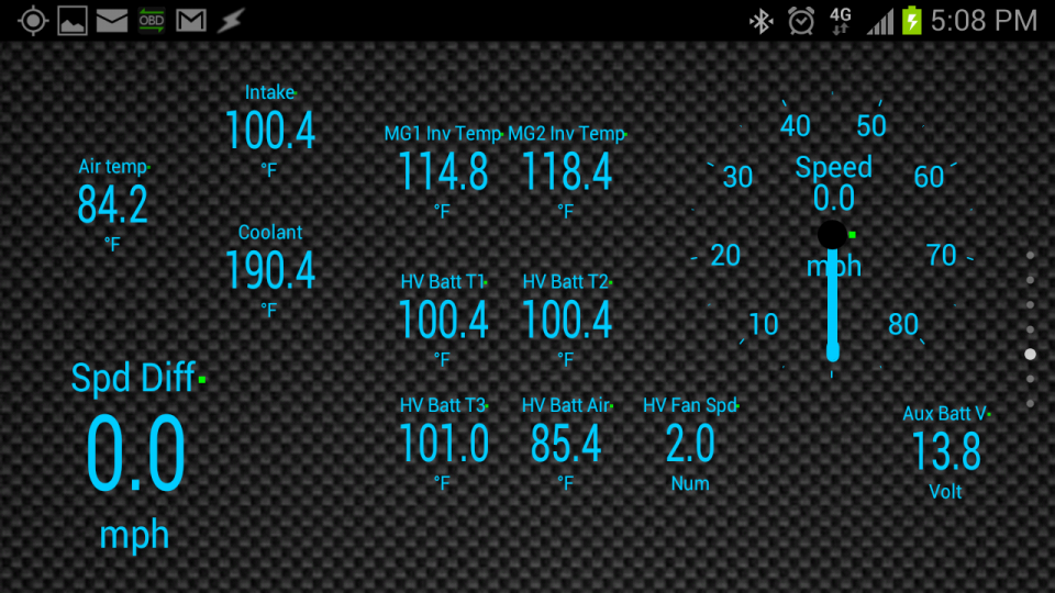

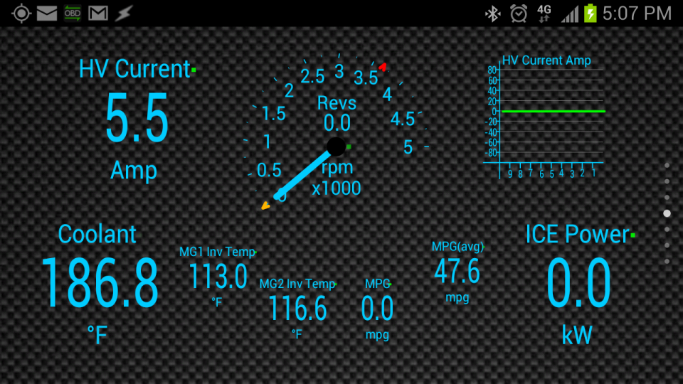

    If you really want to know, it is fairly easy to find out. If you have an Android phone, the Torque app is a great tool. You need a OBDII bluetooth adapter (cheap on eBay and Amazon) and the Torque app itself ($5 on the Google Play store).
    Once you get it all set up, you can read the current in or out of the battery in real time (and lots of other stuff).
    Attached are some screen shots showing how I've got mine set up.
    john1701a and Scorpion like this.
