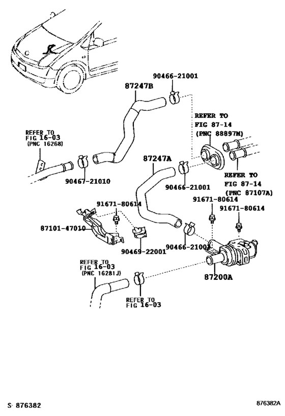

    Gen 2 has a belt-driven engine water pump, so it stops when the engine does. There is a separate electric water pump back by the firewall that has to kick in to keep the cabin heat flowing when the engine is stopped. Has that pump been checked?

    Where exactly it is and what the name of it?

    The pump is part 87200-47030 and it is back near the firewall, within one short hose of the heater core fittings. Callout 87200A here:
    With two thermocouples, you could clamp one to each fitting of the heater core, and measure the temperature difference, how much it drops between the supply and the return, with the heater blower on high. It would be hard to interpret without comparing to the same results in another Gen 2 with satisfactory heat, in the same conditions.
    If it is hot when the engine runs and not when the engine is stopped, I would still lean more toward something like that pump. A clogged core will be clogged the same when the engine runs or stops.

    That's the pump I took off of another car to use as my inverter pump on my '09 That's the pump that's rated at 14 volts The one in the fender well that looks the same for the heat recovery coolant system is marked 12 volt and thus has a different part number but the same plug and they will both run on 12 volt Not sure why the different stickers are on them I have several of these laying in a box here now when my inverter pump goes in one of the other generation twos I used the firewall mounted to the brake actuator plate as my inverter pump. I would be interested to know if that pump is failed also should be interesting to note because this pump usually pretty much last forever it's very well built . That's why it didn't cross my mind in the response because I've never seen one burnt up blown up or not operating I have seen the same exact pump with the different voltage marking in the fender on the left side for the heat recovery tank I've seen many of those bad I've plugged them up and watched them go bad I don't know why they both look exactly the same. And I wouldn't think plugging of a heater core or the radiator for that matter would cause the symptoms you have unless what's clogging is able to move which usually isn't the case. But that's a good call on the pump which I'm not understanding how that could really be anyway because anytime I have my heat on the engine predominantly runs If I come to a stop sign and I don't have the heater on I just have flow through ventilation heat comes out the vents because the car is moving that type of thing. And I stop at a stop sign and then there's no heat coming out If I put the heat to on and put the fan on say medium the engine will immediately start up I guess because of the call for heat I don't know It does it in all of my generation twos and they all have excellent heat they will run you out of the car. Matter of fact I don't even turn my heat on most of the time I leave it off it said it high then everything is turned off and the screen is in the consumption mode I have no fan on but air comes out the vents when I'm moving forward If I get on the highway it can get so hot in the car I have to open a window with no fan running.

    Replacing the auxiliary heater core pump didn’t change anything. Great to know I can use it as a replacement for the inverter pump.
