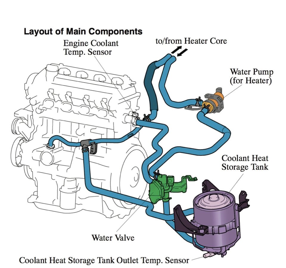

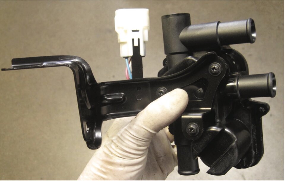

    Gen2 Prius coolant flow through the heater is complex because of an extra water pump, control valve and storage tank in addition to the normal engine water pump and thermostat.
    3 way Water valve
    Possible issues are a clogged heater core, air in the coolant system, a bad air blend door actuator, bad heater water pump, bad water 3 way valve or coolant leaks.
    Because of the complexity Toyota has special scanner based tests. Many of the issues create Toyota specific codes that auto supply scanners can not read.
    If the coolant temperature is 180f or higher and the engine is not overheating, use of Toyota Techstream active tests or another advanced scanner is recommended. Car Scanner is not capable of the active (bidirectional) tests.
    Even bleeding air out of the cooling system is best accomplished with a good scanner.
    Sometimes its better to let a hybrid experienced shop do a diagnosis.
