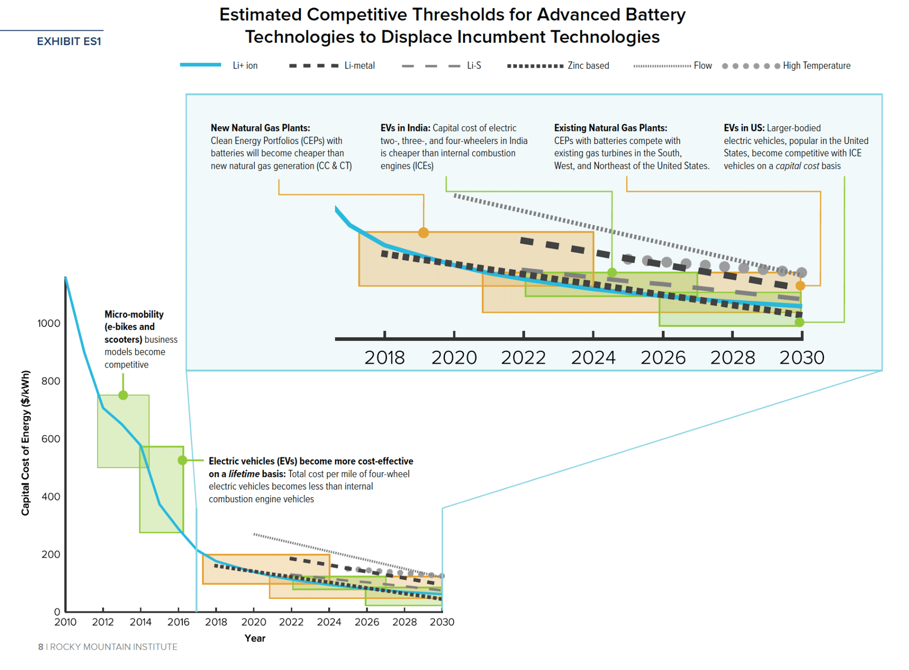

    Source: Breakthrough Batteries - Rocky Mountain Institute
    Rapid advancements in battery technology are poised to accelerate the pace of the global energy transition and play a major role in addressing the climate crisis. With more than $1.4 billion invested in battery technologies in the first half of 2019 alone, massive investments in battery manufacturing and steady advances in technology have set in motion a seismic shift in how we will organize energy systems as early as 2030.
