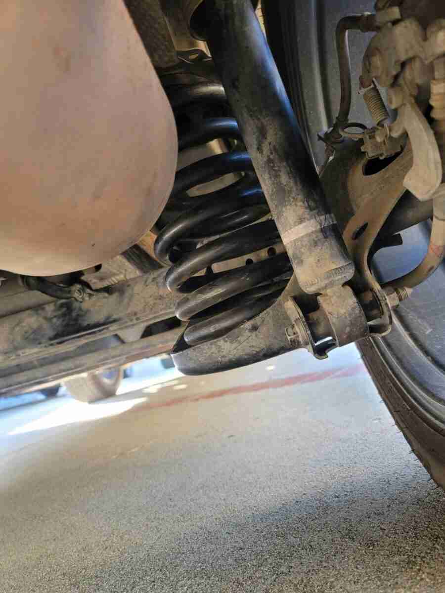

    I did read through this thread regarding the lift springs upgrade. I ordered the stock KYB struts and front/rear heavy duty springs for the upgrade but decided in the end to go with the stock KYB struts and the prius offroad lift spacers.... so here I sit with the heavy duty front springs and heavy duty rear springs with shocks complete as I intended on harvesting the perch from each shock.... As it turns out the prius I own originally had a 2nd battery conversion from Greencar in washington so Im pretty sure it had rear heavy duty springs installed as the rear clearance is almost 8 inches... If anyone is interested in these parts, please let me know, thx

    I have heavy-duty springs on my Prius after removing the rear lift, and even with my additional cargo weight, no rubbing, I am happy for now. Just need struts/springs and front springs now. After the lift kit and spring spacers still had my rear tires rubbing the fender on drastic highway dips.
    Heavy Duty Springs on my Toyota Prius is a game changer! - black_jmyntrn
