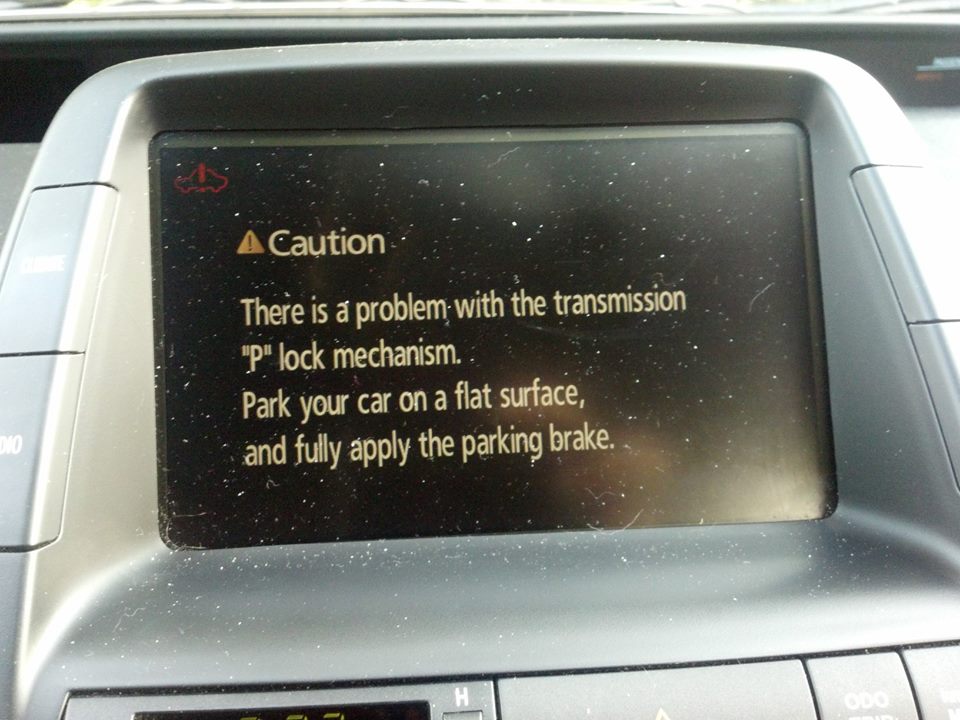

    i was at an intersection and red triangle came on dash and lost all driving functions. Had to turn power off, then turn back on. Was able to drive 100 yards to a parking spot, but it went out again. Reset car again, then it happened 4 more times within 2 miles while driving. Had to call tow truck. Just kept shutting itself down. Please help if anyone knows how to fix this. See picture below for the message I got when it happened. This is the first time my car has malfunctioned like this. I think maybe its throwing itself into park or neutral (judging by the P-lock message below) and cuts all throttle control to car. Has 105,000 miles on it.

    Hi Rooster. The "P" lock warning is a classic sign of a severely depleted 12V battery, however the battery shouldn't normally be depleted *while* you are driving.
    What it sounds like has happened is:
    1. Your inverter coolant pump has failed (fairly common problem).
    2. The inverter has overheated, causing the car to lose power.
    3. The inverter issue also causes the 12V battery to stop charging, and hence your final issue.
    If you let it cool down for a few hours you should be able to drive a short distance if you take it easy. Be cafeful however or you may lose the inverter completely.

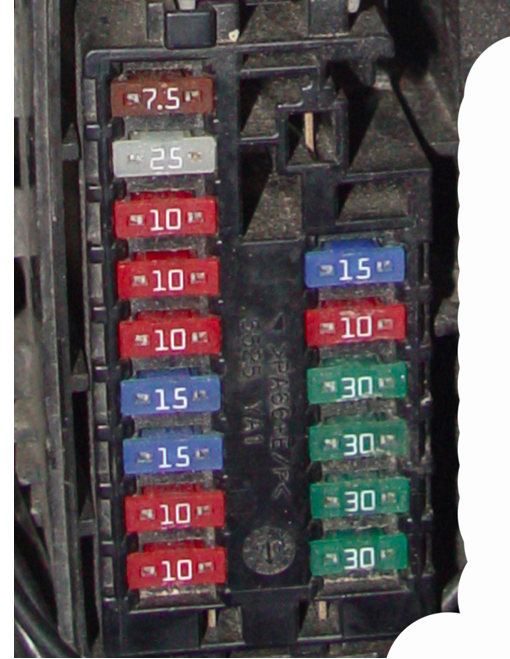

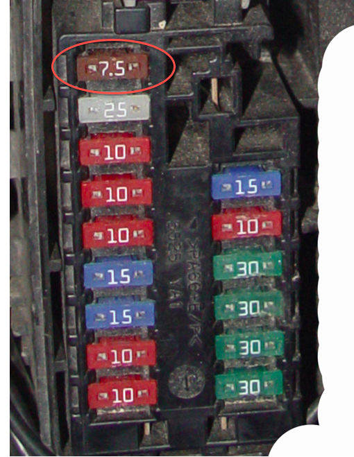

    One other thing that might be helpful for folks who get stranded with this issue: the tech said that if you pull the top left 7.5v fuse in the lower section of the fuse box, leave it out for 30 seconds or so, then replace it (see photo), this should reset the error system and allow you to start it and get it in drive. He also said that if that doesn't work you could try pulling the negative battery cable off for a few seconds and that should accomplish the same thing. Hopefully one of these fixes will allow you to get moving enough to get to a repair shop. We were much relieved that it was such a simple fix!

    Wow how come your fuse box is full of dirt. Where is the cover??
  14. Ray Geiger
    Ray Geiger New Member
    Aug 3, 2013
    Not our car; I lifted that pic off google images. The fuse box is under the hood on the driver side.

    70
    North CA
    Oh I see. That car must be in a junk yard and someone took/bought the cover.
