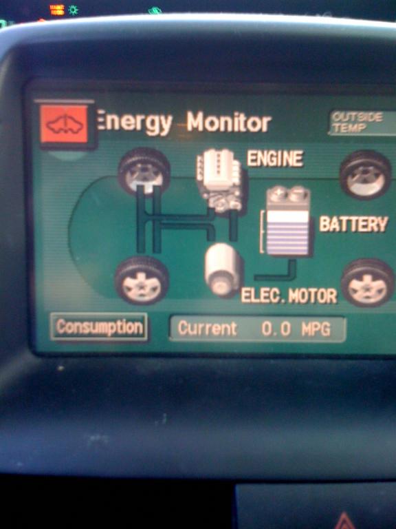

    I'm specifically referring to the outline of a car with an exclamation mark superimposed on it. Is there a name for this icon? What does it mean?

    It means that you need to look at all those orange lights below maintenance required. You need to scan the car and see what the fault codes are

    But I've ID all these. I know what they could mean problem-wise. It's just finding the meaning behind this one is really difficult. It could confirm my theory or not. It could point to something unrelated. I just need to know what it's supposed to indicate.

    Welcome. Sorry you're having problems. You need a Prius capable scanner. Autozone scanners are pretty limited. Take it to a Toyota dealer or a reputable shop that works on hybrids. What you're seeing are not codes. They are just indicator lights telling you "It be done broke." From the age of the car and the lights you see, I would expect then to get codes for hybrid battery failure, but you need to have a proper ready to know for sure.

    My question wasn't about codes. I didn't ask "what's wrong with my car." I just asked about the specific meaning of this particular icon. Because I'm at work it and don't have the manual at hand it took some time, but I did manage to figure out what this particular icon means, no thanks to any of the responses I've received here.

    The meaning of that particular icon is "the hybrid control system has detected one or more of its roughly two hundred detectable problems with the car, and has stored diagnostic codes to tell you the details."

    Now I think I get it. Yes, that's been answered. It means your car has a problem and you need to get it checked.

    Per the OM, the official term is "Hybrid System Warning Light" and when illuminated indicates a problem with the Hybrid System exists. The operator response, again per the OM, is "Take vehicle to Toyota dealer immediately".
    Most independent shops will not have the necessary tooling or training to address hybrid issues, regardless of their other competencies.
