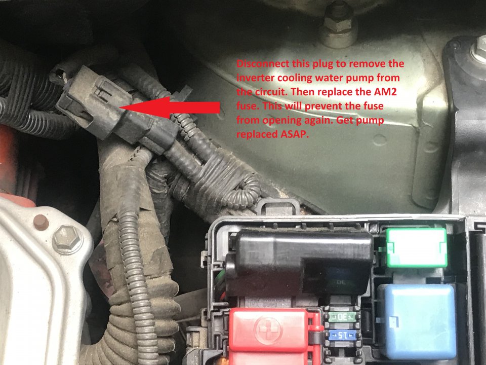

    If you find it to be blown, before replacing the AM2 fuse, disconnect the inverter coolant pump at the connector shown in the image below :
    Brian1954 likes this.

    Just went through this yesterday with a guy on the telephone 400 miles away you say your display is blank this is the eyebrow display that's directly in front of you that shows the gas gauge the transmission selection and what have you this is not lighting up when you try to ready the car is this correct? That's the CM monitor display issue that can make the car hard to turn on and doubly hard to turn off to the point where you have to hold the power button till you see everything go blank or what you have on go blank and so on so first you want to check above the am too fuse if it's blown you're going to undo the black plug that doji circled above and then replace the am2 fuse and then get in the car and attempt to ready the car put on the brake one push of the power button if the am too fuse was blown and you unplugged the black plug and replace the am2 fuse the car should now light up and ready and drive if you're under 80° outside you should be able to drive pretty normally for 50 or 60 miles without even noticing that the inverter pump is not working other than a light being on and a code being present for the inverter pump this will not ruin the car it's the inverter fluid gets too hot because it's too warm out and you're driving fast it will slowly step back charging the hybrid battery and if you continue to do this you'll eventually get your battery low enough where your car won't really be moving so driving around town locally and 80° weather probably is not going to give you any problems but you want to get the pump replaced and the black plugged back up as soon as possible and that doesn't mean a year from now although I drove a Prius in North Carolina without an inverter pump in place or a dead one in place not working for a year easily and didn't damage any other part of the car and drove it everyday because that's what I do drive everyday. No problem so run these quick checks and see if you're back to driving and then you know what to do
