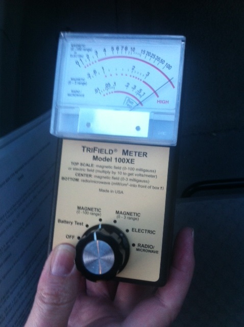

    A friend of mine has been battling with some serious unexplainable health issues over the last year or so. She owns a Camry Hybrid and believes that the higher than normal EMF emissions are causing her problems. Some of her symptoms include: toe nails falling off, hair loss, rashes, numb feet, extreme fatigue. She brought her Camry over and her EMF reader and showed me that the gauge topped out, so we weren't able to get an accurate reading (it was this high even two feet away from the car). I took the same EMF reader and measured my Prii, which both read only about 4mg. She has offered to trade her car for one of mine (hers is a lot newer and I would love to) but I am not sure if this is wise considering all of this EMF business. I am not looking for a debate, just some advice and clarity on the issue. I want to help my friend, even if it is to reassure her that everything is normal.

    There is no scientific evidence that non ionizing EMF is in any way harmful. (By this I just mean repeatable, double blind, experimentation) However, for the placebo effect alone, I would bet your friend would improve if you swapped cars. Since you know that it was not the actual cause of her symptoms, there is no reason for you to get any.
    In previous EMF witch hunting, the strongest source of EMF in a Prius was the vent fan behind the rear passenger seat.
    I would test the Camry with the fans all off.

    I tested it while it was parked and driving, but I don't remember if the fans were on or not... I just wonder why her reading was so much higher than in my Prii? She and her husband swapped cars for a few months and now he is complaining of health problems too btw. I think she should just get rid of it, but I'd like get a full understanding of what's really going on first before we make a swap.

    That reading seems high regardless of whether it is creating a health problem. I would get it checked.

    High relative to the Prius EMF. Scientific purpose was to see if the EMF was abnormally high, thus causing potential health problems. The measurement should not be that high compared to a Prius that is sitting five feet away from it. If anything it would be nice for her to have some definitive answers, but this topic is a bit taboo, making it tough ask for help without getting snarky or smug answers. I will do all the data collection that I can within my abilities to help her, but first I am reaching out for help in understanding the possible causes of these high readings so that I am well informed.

    In other cars, fan motors seem very 'leaky' One suspects they are made to be cheap, not efficient.

    Oh duh, lol. In my car the EMF was highest in the drivers floor well, which I am assuming has something to do with the inverter, and right by the HV battery itself.

    Drivers floor well near where the HVAC fan is? And if right by the HV battery is right by that vent at the rear passenger seat it may be that fan.

    I wonder what the emf readings are near MRI, I would try to quantify what the readings are showing. If the emf of this car is 100 times or 1000 times more than your prius, there must be something wrong. I don't think it is likely the cause of the health issues. but I wouldn't want to drive a car if the emf was crazy compaired to other cars.

    Take a incremental approach to finding the source. Make all the measurements at the drives seat with the meter in the same orientation for every reading. Write down the readings because trying to remember everything is not going to pinpoint the source. Take and record the EMF in the following conditions.
    1) Start with the car completely off to determine the baseline reading
    2) Don't start the car but just turn on the AC, fans, radios, and anything else that can be turned on without putting the car in Ready.
    3) Turn everything off including the AC and put the car in ready.
    4) Turn on everything one thing at a time.
    5) Record, record, record.
  20. Houston Hybrids

    Thank you, I will do just that! The only problem is that everywhere in the car gave me the same reading while driving and while stationary. I will try again with the gadgets off and see if it changes!
