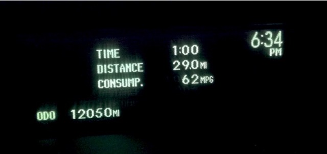

    I took this photo this evening. Car had depleted battery (it was last connected to the charger about 150 miles ago). Getting 62mpg is not difficult ... given the fact that a noob like me was able to achieve it. My wife drives it like a regular car (she has no patience to monitor the gauges) ... And she mostly gets around 53mpg (without charging).

    It looks like your avg speed was 29 mph. If I drove that slow, I could get 62 mpg on my standard Prius with no problem. Energy and matter could not be destroyed nor created. Therefore, if your battery is depleted and continue to drive, all of the energy will be coming from gas. At that point, the only advantage the PiP has over the standard is the bigger battery to capture regen energy. So if you were going down a very long hill, you will definitely be able to capture more energy than a standard Prius and potentially get better mpg. On flat land, the PiP with a depleted battery has no advantage in mpg.

    You read it wrong. The figure 29 is the distance in miles ... Of which 6 miles or so was on the interstate. It was up and down the ramp a few times.

    The distance is 29 and the time is 1 hour, so the avg speed is 29 mph. I can get 76 mpg on local roads

    That's not what the value represents. It includes the time the vehicle is not in motion. So whenever you stop and the system is on, that counts against the speed... giving a false impression of actual travel, but a very accurate measure of overall. That average takes everything into account.

    I think average speed is a useless metric in such cases. A stop and go traffic is not as efficient as going at a steady pace ... even if the averages are the same.
    I don't think i will ever consistently get 76 mpg on my plugin (without charging) on local roads. ... And Fuelly.com caps out at 60mpg for the regular 2013 Prius.
