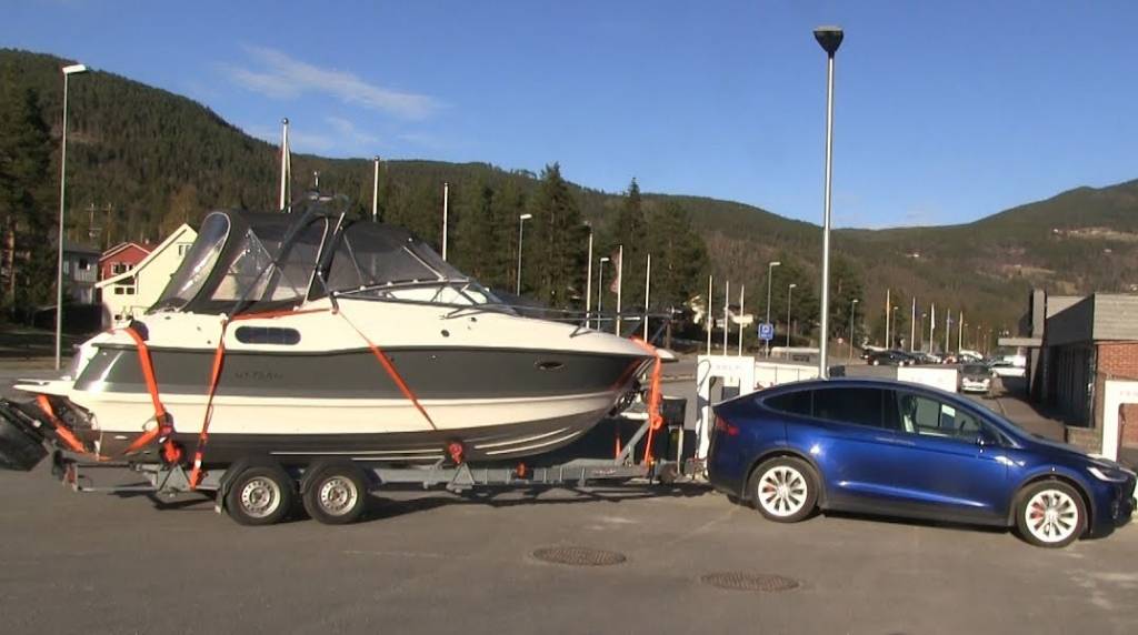

    Even in our semi rural area south of Nashville the trailer & boat owners use their F250's (easy to spot with 8 bolt rims) trailer hitches once a year if even that much. The mileage really sucks even if you're not pulling anything. And when you do, massive mileage hit .... nevermind that $100+ that it takes to fill it.
    But hey - even the model X drops from 85MPGe to 'only' 50 MPGe when it pulls a 6, 800 Lb boat
