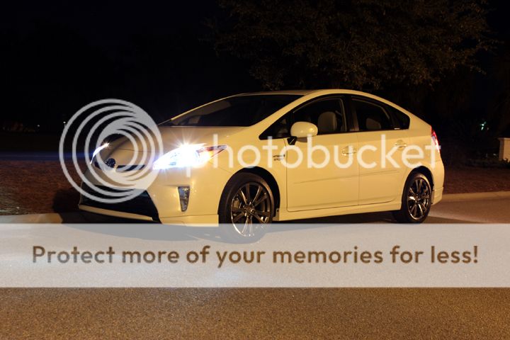

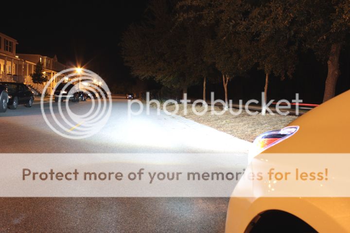

    Well, I just got my TRS HIDs. Looks good for a temporary set up. Looking for a set of used but good condition headlights to commence with the retro fit.
    Overall i like it. I didnt really drive it yet. i took it around the block and thats about it. i have to get rid of those squirrel finders.
