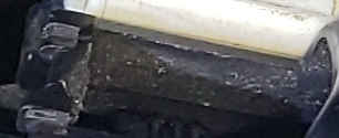

    I cannot make a click. There is only one way it fits (3 grooves). I inspected both ends of the plug, nothing seems in the way. When I line the back of the black plug up to the end of the white part, it looks to me that the black part is too short to ever fit fully over the white notch and lock them together. There is a rubber seal/gasket inside the black plug that is tight enough that I hear a light pop when I pull it back off, but that's all I can do. You'd have to hope that it never vibrates loose. Does this make any sense?

    There’s no locking lever on the back? It’s so far back I could barely touch it, but could feel something on the far side.
  8. ChapmanF
    28,680
    18,982
    it doesn't have to go all the way over. Just far enough to click.
    Is it possible your SIL broke off the clicky bit while removing it? Then it's just a matter of pushing it on and thinking secure thoughts.
    This looks to me like a possible busted place;
    That little wire extension, if my research skills haven't failed me, is part number 82124-47040, and probably under $20 brand new in a box from a Toyota dealer that sells at discount (list is about $26).
    This picture shows the little extension with the actual sensor plugged in at the end, but of course the 82124-47040 part is just the wire extension.
    Pulling it off a salvage car should be even cheaper. Just don't break the clicky bits pulling it off!

    @ChapmanF You must be right, I was thinking the same thing after Mendel's suggestion. I took a better pic of what looks like it broke off, showing the interior material of that clip.
    What a hassle this, but it is satifying to solve the problem. That is... going to fill it back up with oil and leave it connected like that for now, maybe wrap some tape around it, and then see if the temp light is gone.
