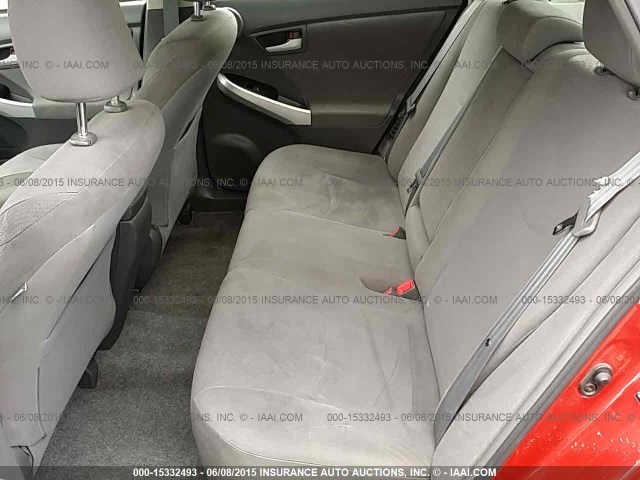

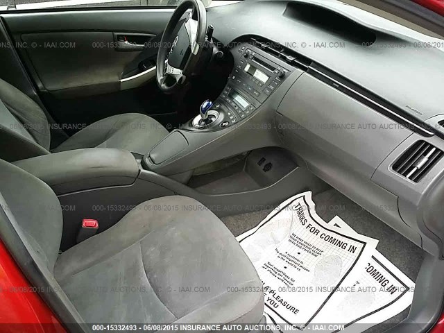

    The interior looks pretty neat from the IAAI pictures (find attaced). I have an OBDII and torque app. Can you run me thorugh the process of testing the state of the batteries.
