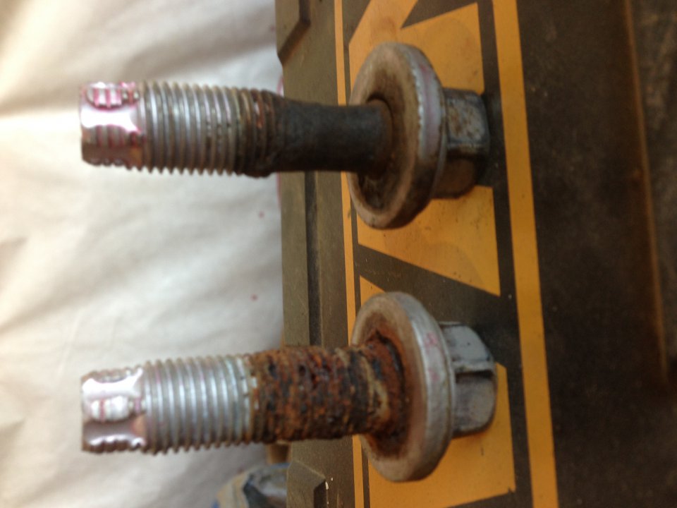

    I am replacing the struts on my 06 with the touring springs and bars, had to drop the front suspension from the unibody, upper bolts were pristine the two lower bolts I will attach a picture as it must stay moist or hold road salt, but it will be wise to replace them. image.jpg

    Wow. Those are nasty. Maybe worth mentioning to Toyota and/or NHTSA.

    Was the bolt at the top of your photo loose? Pretty amazing to see how much of it had corroded away.

    Was not loose but I have to get them before I put it back together, I don't think the one would make torque up.

    I would definitely send them off to Toyota, with their history as you know it. They may have had a bad batch of bolts from a Chinese supplier or something. What's one more recall? :) Where do you live, BTW? I think if I lived in a corrosive environment, I'd be tempted to pull the lower bolts on my '05 and have a look at them. Do you remember which sides the bolts came from?

    They are the rear 2 bolts on the front cradle plate I had them out to remove and replace the front strut bar. The car was bought new and my wife drives it to work and back and it's in a garage at work and home. We live in West Virginia.
    Part number is 90119-14125 With a breaker bar the jobs 5 minutes to change them out, when the new ones come in Monday a will coat them in moly and torque them up. I have 4 prius I am changing all mine.

    I am stewed about these bolts they had to be removed by the Toyota dealer not long ago for the steering recall, the bastards reused this bad bolt!

    Or, they needed a good bolt for a friend's car and used yours, putting the bad bolt back into your car. Someday, I hope to find a dealer I can trust.
