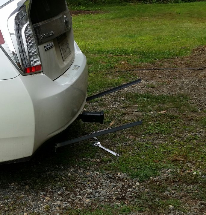

    20140831_135509-1.jpg I ended up adding this bracket to mine, as the weight of a full size spare tire and a large job site storage bin seemed to put more twisting stress on the hitch point than I would have preferred. The hitch rack slides in to the receiver and two u bolts with rubber "pads" connect the two arms you see to the outer reaches of the rack. Much improved stability.
