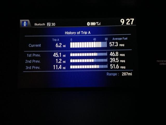

    Interesting but we really need a proper study. This snapshot suggests there may be a 'hole' in slow-speed performance:
    39.5 speed < 46.8 speed < 51.6 speed < 57.3 speed​
    If slower speeds are in serial-hybrid mode, it makes sense. When the engine generates power there is typically a 92% loss in the generator to the electrical power out. Then the motor typically has a similar 92% efficiency from electrical to mechanical power. The product is the end efficiency, a 84% system.
    This is why we need to see an mph vs MPG chart that covers the cruise control range . . . for a warmed up car. This will also show any "knee-in-the-curve" where the car transitions from serial-hybrid to mechanical-parallel mode.
    In contrast, the Toyota system always splits 28% of the engine power out the equivalent, lossy electrical path, and 72% via the ~98% efficient mechanical path. Depending upon how much urban driving one does, this could be significant.
