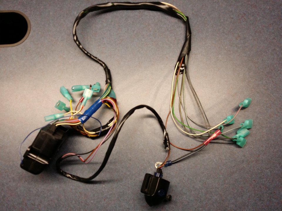

    Thanks for the alarm ideas--- there is a little mystery gizmo under the dash just inside the driver's-side door with a blue light on the front. I reached under it and it does have a button to depress (which I did numerous times in varying combinations but there was no change in horn behavior) so at some point this week I plan to take it to my car guy and see if it's one he's familiar with.

    That is definitely part of the dealer installed alarm which they charged u ~$600 for when u bought it.
    VS980 4G ?

    Nah, no specific charge for it. I got the car used after my 2005 was totaled. I had intended to skip the 3rd-gen Prius and get a 4th-gen as my next car but a careless semi driver decided otherwise for me :)
    If it's a common brand/model alarm though, I am hopeful that I can get that maddening honking disabled ASAP.

    And the offending device removed and all is well in the world! Thanks, all.
