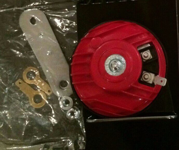

    It looks like u have the copper ring terminal that can be used for the ground (see croped pic)

    Feeling foolish, but how do you used the cooper ring terminal as a ground?
    You don't. I was just confused by the prior post and should have ignored it and just installed positive cable to blade terminal on horn and bolt on horn to frame.Thanks for the quick replies.
    So the horn bolt that connects it to the frame IS the ground. The other terminal is unnecessary when installing on a Prius (or most cars in I suspect). Wasted a trip to Home Depot, but very happy with how the horns sound!

    The negative terminal on the battery is connected to the car frame, so any bolt or screw on the metal frame becomes a ground point.
    So, put the ring terminal between the horn and bracket and mount it. The terminal then becomes the negative terminal on your horn hookup. The terminal on the horn is positive.

    For the FIAMM El Grande horns I didn't even use the copper ring. I just mounted the horns and plugged in the connector to the terminal on the horn. Everything's been working fine.

    The center mounting bolt on the horn is grounded to the chassis. Your horns should have come with 2 eyelets with plugs, attach as shown on the left below. The two prongs on the horn are not polarized so you can attach the ground to either one.

    For the El Grande horns:
    1. Did anyone else remove the red plastic covers? They don't seem to do anything but are just aesthetic. Mine were already falling off (some kind of adhesive over a screw holds the plastic cover on ... poorly in my case). Seems like unnecessary weight and without they are not going to draw attention from the service departments. I removed mine and it doesn't seem to impact performance.
    2. Did anyone remove the "grills" over the horns' main openings? Looks like they're held on by a few bent tabs of the metal grill over the lip of the horn. I left them on to keep bugs out I guess, but I think it is mostly for looks. Any experience?

    I removed the red plastic covers and the grills. The covers would interfere with a solid connection to the mount which grounds the horn. The grills have the potential to rust, loosen and rattle.

    That is absolutely the way I did it. The terminal ground connector on the horn is the same as the grounded mounting screw post. Normal for most horns including the OEM Prius unit (no ground terminal, grounded through mount). I think the available ground terminal is for mounting installations in situations where the mounting area is not grounded (perhaps a non metallic area). My second set of horns will be arriving tomorrow for installation on the wifey's Prius. No more meep meep in our family!

    Good to know! I was getting thrown off from this DIY instruction because of the grounding wire. I understood how to ground it, but the problem was the El Grande horns didn't come with the grounding wire–only the gold prong. I agree with you that it's probably there for a different vehicle install.
