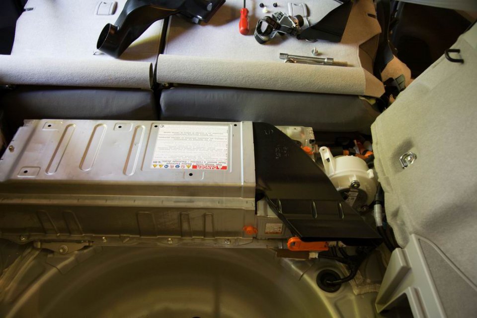

    So other question: where's the fan located for the battery and does it run when the cars ac is on and when the battery is at a higher temperature?

  18. Mendel Leisk
    61,506
    42,323
    The fan's the white cylindrical at right side of battery in this pic. The black tube piece sitting on the flipped-down seatback connects between the fan and the back seat vent grill.
  19. GaryHere
    GaryHere Member
    Jul 27, 2014
    147
    27
    Arizona
    Thanks for that great pic, nice to get an idea where the fan was.
