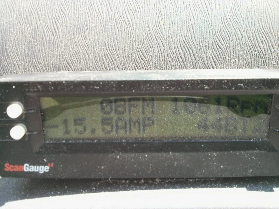

    An example. I took some video as well which I'll edit down, but the fan didn't start for the first 5 or so minutes, and batt temps went from 44 to 48°C, and as high as 49°C. At one point, the A/C was cut as I accelerated in an effort to temp shed load. Acceleration was quite sporadic (surging) too. Photo below shows BFM at 0, ad BT2 at 44°C shortly after starting. Outside temp was 104°F, and the car is parked in the sun.

    I captured a 20 minute drive on camera, and trimmed it down to 10 mintues looking at a ScanGauge II. Probably boring for most, but it takes 4-5 minutes for the fan to even turn on, and another 1-2 for it to ramp up to full speed. I also tested the fresh vs. recirc theory. All that did was drive up A/C load (I saw 2000W on fresh in Eco mode).
