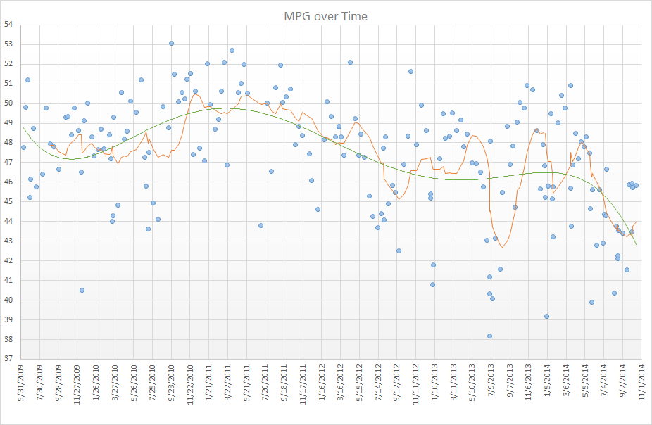

    Another followup - looking at my fuelly data, and graphing some moving average/trendlines, it's easy to see the impact summer temps have on MPG, especially over the past 2-3 summers. A couple of the low MPG outliers would be road trips into headwinds and/or high speeds.

    Or cheating gas stations or variation in pump shot off..
