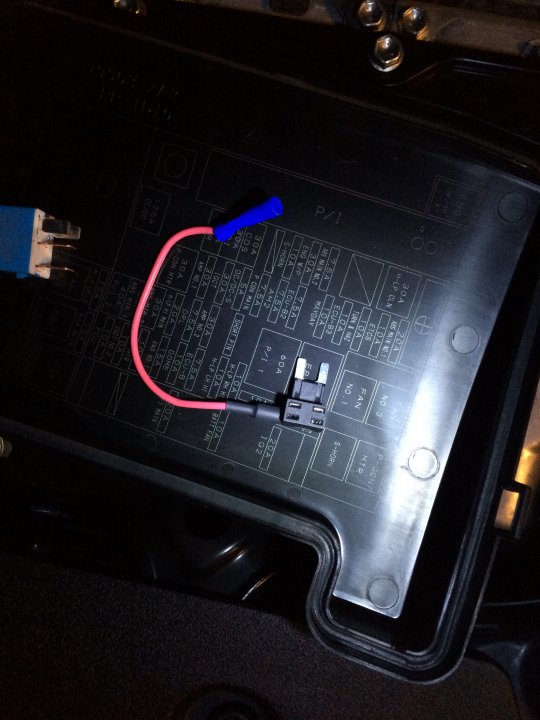

  16. Matthew Mai
    Matthew Mai New Member
    Apr 27, 2015
    Riverside, CA
    BUMP of an old post.
    When I plug the piggyback fuse mod I made my DRLs no longer work. Any idea why this is? I reversed everything and they work again but I want them to stay on with my headlights. Thanks!

  18. Matthew Mai
    Apr 27, 2015
    Riverside, CA
    That is what i originally followed. This is what I made and how i connected it but as stated before. No luck.

  19. xliderider
    xliderider Senior Member
    Apr 19, 2012
    8,084
    3,237
    Honolulu, HI
    You probably plugged the terminal from the tapped fuse into the wrong socket/connector in the DRL relay socket.

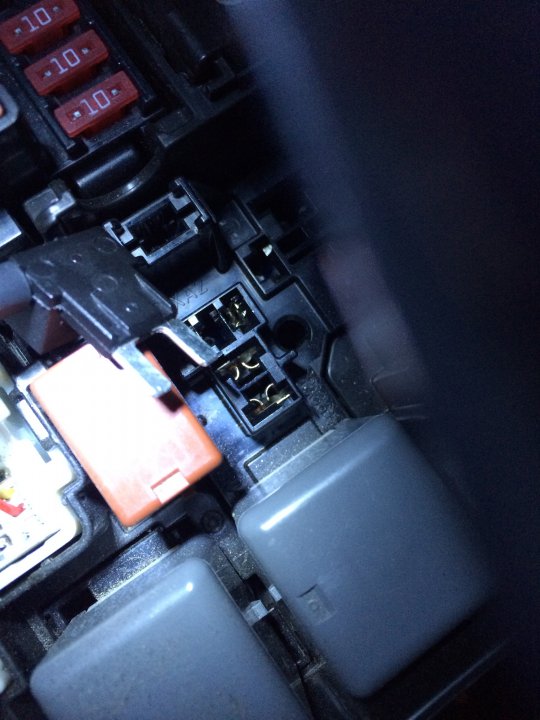

  20. Matthew Mai
    Apr 27, 2015
    Riverside, CA
    Its the middle one where the DRL relay socket is correct?
