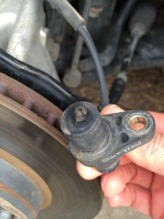

    How do speed sensors fail? Can bumpy roads cause a failure or is it just age?
    I think that the Elec Stability Control requires the speed sensors. Thanks.

    That looks like it was rubbing on something. Was it secured? Correctly? It looks like it was at an angle.
  3. ChapmanF
    28,721
    19,019
    That also might have been caused by a foreign object getting in there. The rotor on the axle that passes near that pickup has notches or teeth, like a gear. There is normally no mechanical contact—the sensor just picks up the teeth passing by in its magnetic field—but if a piece of something hard does get in there somehow between the sensor and the rotating teeth, well ....
    And because of its magnetic field, the sensor might sometimes attract a small piece of metal debris from somewhere.
