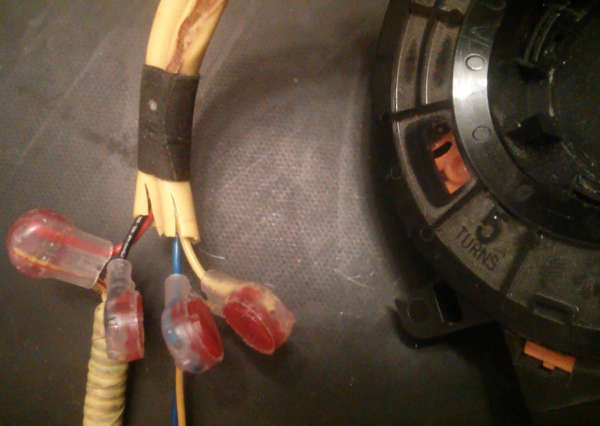

    That reminds me of a new step I've recently vowed to add whenever I'm checking out a used one. A skinny inspection camera can easily be poked up through the hole in the steering wheel where the cruise control stalk comes through, and show how the connections look back there, or whether there's some surprise like this waiting to be discovered.
