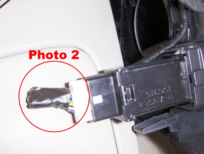

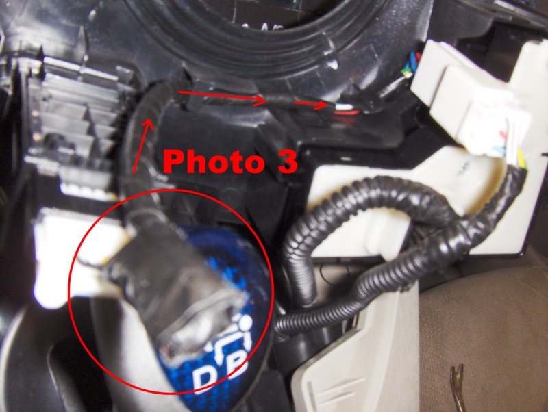

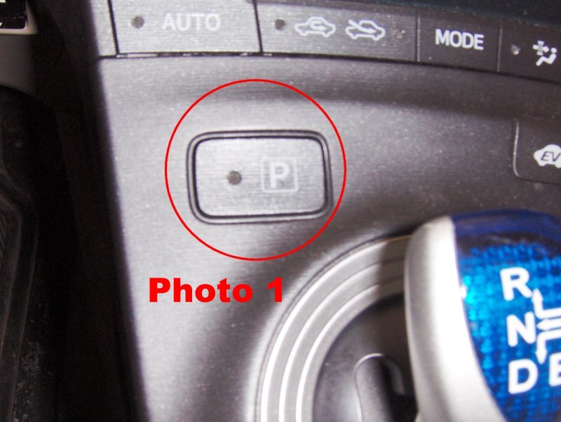

    Okay, so I am the one who originally asked the question, and it's just killing me how it works. So, I took my dash apart this morning, and now the mystery is solved. I've included pictures.
    Photo 1 shows the top side of the "Park" button.
    Photo 2 shows the underside of the "Park" button, and what appears to be cut off and taped wires (see the "red" circled area). This is what I was referring to when I originally asked the question.
    Photo 3 solves the mystery. Had I taken the time to look at the other side of the underside of the switch, I would have seen that what appears to be cut off wires was really a folded back and taped wire (see the "red" circled area) that goes to the connections to illuminate the lights and operate the parking brake (follow the "red" arrows). If any of you ever take this apart, it's very inconvenient to flip it over due to the cramped space & length of the wires to the other buttons on this piece (EVO, ECO, power & hazard light switch).
