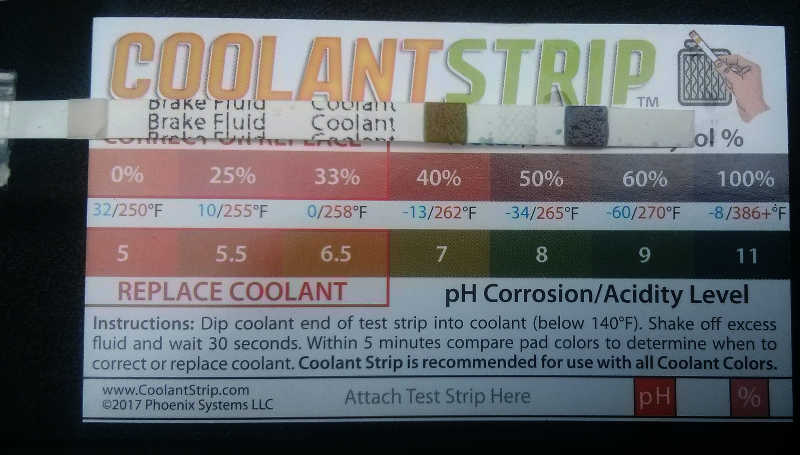

    The same warranty and maintenance guide containing the page up in #2 also has an "inspect engine/inverter coolant" every 15,000 miles or 18 months. (In fact, every one of those "inspect" entries has a footnote number that you can follow to instructions at the back telling you to drain and refill. How that's different from "replace" is a bit beyond me.)
    I don't replace mine that often, but inspecting it is a good idea. Test strips for that purpose are available.
    When the coolant stops being anticorrosive, it can start being a danger to things like the head gasket.
