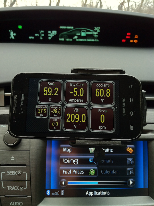

    I am running Torque with Kiwi Bluetooth and it can read 0.1%.
    Here, SOC is showing 59.2%.

    That doesn't seem right. What does it show after a full charge?

    Are we comparing different parameters?
    I just realized that I have been looking at the minimum SOC, not the present SOC.
    Looking down the list of Torque parameters, I only saw SOC Min and SOC Max, so selected SOC Min.
    If I'd looked further I would have seen State of Charge and State of Charge (All Bat).
    (What's the difference between these last two?)

    State of Charge is from standard OBDII mode (01). The other is from Toyota specific mode (21). They both are pretty much the same.
