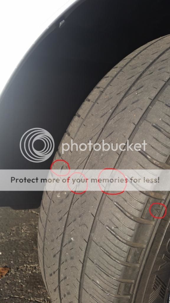

    You should think about replacing a tire when any of your tire wear indicator bars (located within the grooves of the tread) is even with the tread - or even before this happens if you drive in wet/winter conditions. The picture below is of my Yokohama Avid at 72k miles right before replacement due to a planned Lake Tahoe ski trip (I wasn't planning on taking these tires to the snow!). If it were summertime, I'd likely would have rolled another 5k miles on the tire. In the picture below, I've circled the tire wear indicator bars (which can be located by finding the arrows on the sidewall of the tires).

    There's no special point where the tire suddenly becomes unsafe, but as it approaches the wear-indicators, the tire's effectiveness on water, mud, snow or ice is reduced. Some people keep driving until the grooves disappear, and some get new tires every time they change between summer and winter tires. It's all about acceptable risk.

    Use the penny test, look for the "time to replace markers on the tyres," and give a close look at each tyre for cracking and/or uneven wear.
