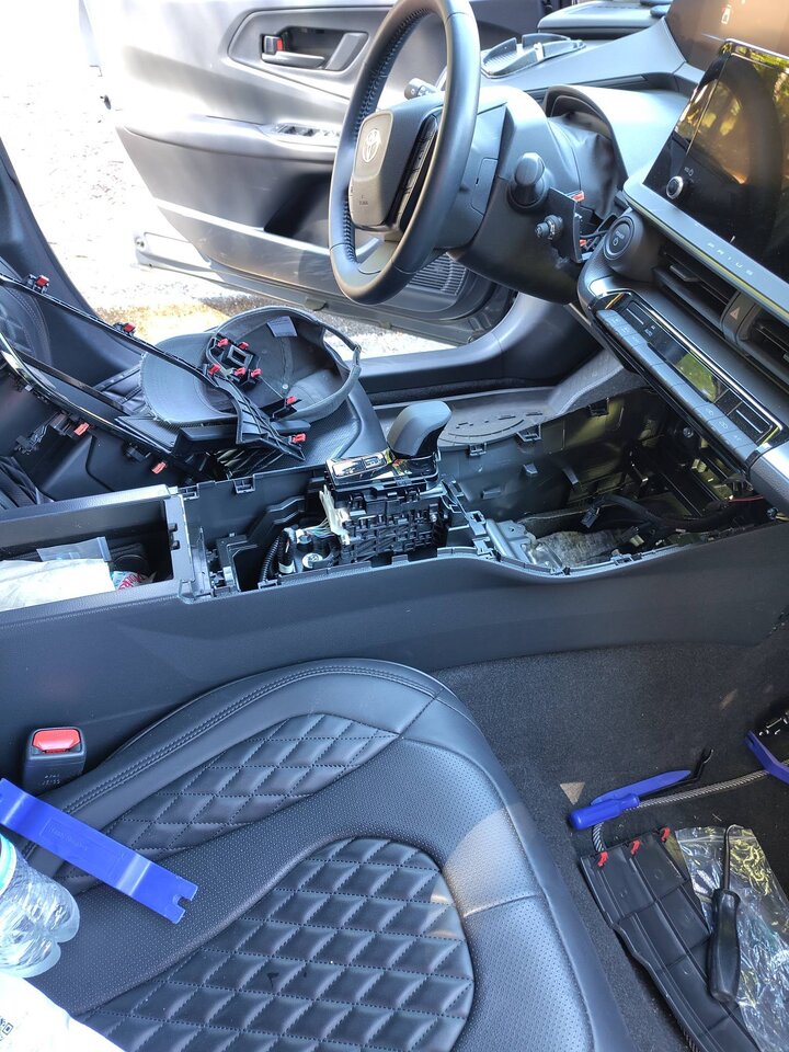

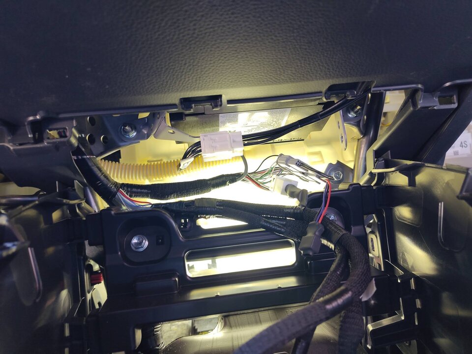

    You need the center console out. Which means you need the trim piece above it out first. You will then be able to see the underside of the DCM and the wires in the rear of it will be accessible.
    To work with the wire harnesses plugged into the DCM:
    • You need the glove box out for visibility.
    • The passenger inner kick panel should also come out because it's a great area to have a flash light pointing directly up and lighting up the work area.
    And that's it. Using a pick tool (google "curved pick tool mechanic" without the quotes) you can stick your head in through the glove box opening to see the back of the DCM while your hand comes in through the center console area with the tool to unplug whatever wire harnesses you desire.
    If you decide to do anything with the wire harnesses make sure to secure them tightly so you do not introduce any rattles to your dash area. You can put some felt tape around that area and zip tie the floating harnesses to the main wire run.

    A note for a side effect of unplugging the DCM: Wireless Android Auto will fail to pair automatically. The microphone, while it's not getting power, still registers a physical connection when the harness is plugged in. Likely through some resistance check. If the head unit can't find it, the head unit can't pair to your Android phone in PHONE MODE. It can pair in MEDIA MODE though. And from MEDIA MODE, you can then pair to Wireless Android Auto.
    If you try to manually pair in PHONE MODE with the microphone disconnected (because the harness is unplugged from the DCM) the head unit will scold you and tell you it can't because it can't find the microphone. And apparently Toyota did not think to do an if/then statement for this edge case. "If microphone not found, then pair in media mode to initiate android auto pairing". Instead it just fails over and over.
    This does not happen if you only pull the fuse for the DCM but leave the harness plugged in.
    You can make your own dongle to bridge it or you can pay for a DCM dongle.
