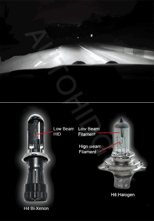

    I got a kit for $50 shipped just to try out since I knew nothing about HID. The cheap bulb that came with it looks like this below.
    The light scatters from the white base of the halogen high beam. I had to point it down, way down. Avoid this type of bulb. I took a pic with this installed with my cell phone below.
    As I look for a better bulb, I got a pair of bulb like this one below for $40. This is the Hi/Lo bulb that can move up and down with a magnetic switch. The center bulb can be slide off (from the green line) and you are left with the exact shape of H4 bulb. This is needed for the rubber boot to seal off water.
    This bulb also can be adjusted as well. I plan to install it this weekend. I will take more pics and possibly video as well.

    Yeah I was wondering about the first bulb. It looks like a halogen bulb next to an HID capsule.

    The kit is bi-xenon so the low and high beams are activated by the magnetic switch at the bottom of the bulb. The bulb actually moves up and down.
    I found one down side with this approach. The bulb shakes when I go over the bump. It is somewhat annoying but I can live with it. I don't know if that will affect the life of the bulb.
    You can get the kit for $60 - $80 on ebay so it is a much better value than $50 for the Phlips X-Treme halogen.
