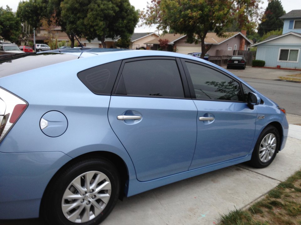

    image.jpg I love the way it stands out

    Type in CVRP in google. The first result is what you want. I got a blue one too. I really think you made the right choice in the PiP. All it takes to convince you I think is one day in heavy traffic and you cruise through traffic in HOV lanes.
