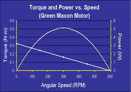

    Electric motors often produce maximum torque at 0 RPMs, sl it helps the Prius at low speeds a lot, not so much at high speeds. (This is a generic curve, not the actual Prius M/G2, the starlight line is torque, the curved line is power))
