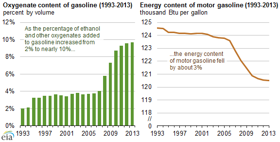

    I always thought (and still do) that ethanol was a dumb idea for a myriad of reasons. The biggest reason it became a thing was industrialized agriculture. Corn producers could make more corn than there was market for, so a new market was fabricated. The lower energy content is only ONE of the reasons that it remains a dumb idea. (Some of the others can be found in small engine carbs / fuel systems everywhere).
    Given that corn surpluses became so common, they should have gone into making more whiskey instead!!
    (U.S. Energy Information Administration - EIA - Independent Statistics and Analysis)
    #12 Josey, May 13, 2022

    Excellent graphs, thanks for posting!
