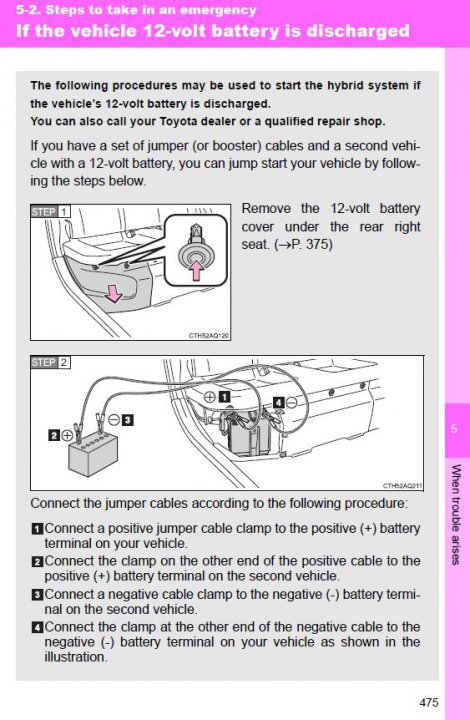

    I just cannot believe that the only way to jump a 2012 Prius C is to open the hatch in the back seat and try to find the terminals that are EXTREMELY WELL HIDDEN and hope you don't start the thing on fire in the process.
    It was 50 BELOW ZERO in Fairbanks this past winter and several friends and I were trying to do this in the dark. YOU try it, my dear Toyota engineers! Trust me. That is HELL.
    Now it is dead again, heaven knows why. I absolutely ADORE this little car. But I can't deal with this horrid engineering disaster. I am never going to jump it at -50 again. I am going to trade it in for the newer model that doesn't have this dreadful FLAW. I can't risk that this will happen in the winter. It is an absolute major horrible hassle even in the summer!
    Great little car. Horrible, terrible AWFUL and inexcusably bad design on the 12 v battery. Love the car. Curse the engineer who designed this part of it.

    You should have received an OWNERS MANUAL with your fine little new car.
    In it should be a page that tells you how to locate the jumper points that are located in the engine compartment and are (more or less) plainly visible and easy to access. :)
    AND if you haven't been in Fairbanks long enough to know this already.........almost NO VEHICLE will start at -50 F without taking some effort to plan ahead and do things like connecting a battery maintainer AND some kind of block heater.
    P.S. Your local Toyota dealer would be happy to show you those connection points AND recommend what others do to ensure that their hybrids will run in the winter time.

    "You should have received an OWNERS MANUAL with your fine little new car. In it should be a page that tells you how to locate the jumper points that are located in the engine compartment and are (more or less) plainly visible and easy to access. :)"
    Re-read the OP's first paragraph, in which she tells you she has a 2012 model; like mine it does NOT have engine compartment jumper points.

    the jumper point on a 2014 is a flat spade connector buried in plastic next to a 100AMP wire. did i mention it is ONE HUNDRED AMP !?! i hope the upgrade fix Toyota for 2012 has better safety for you. the 12v jump point 2014 on my c1 seems unacceptable already. and PLUS you have to GUESS where to connect the negative wire on the engine. or motor. or ICE. ? good luck

    I don't understand your concern over 100 amps.
    The spade "connector" probably is connected directly TO that 100 amp wire.
    A normal car battery is capable of delivering 300 amps or more at the battery terminals.

    Regarding step 4 above: they say to make the last cable to the negative battery post. I've always heard it should be to grounded bare metal on the engine or frame, ie: away from the battery, since it tends to spark. There might not be any decent bare metal in the vicinity, though.
